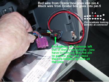

I am sure some other members here will be able to offer some additional information. However, just by reading your post it is in my opinion that it could be a simple wire connection of the voice harness. I believe this is the red and black wires that are connected to the Onstar Module (please correct me if I am wrong). I will provide some directions and pictures below for your reference. Please note that these are not my pictures or directions, but rather from information that I have gathered elsewhere. There is a reference to a gray connector. I know these wires can be purchased on eBay HERE

VSS KIT INSTALLATION – VOICE RECOGNITION
(GREY CONNECTOR)
Using screwdrivers gently pry out the plastic side clips holding the Onstar box in place to release it. Use another screwdriver to lift up the front of the box so it can be pulled out.
Note: The box will not come out very far.
Select the VSS Kit GREY connector with the red (or white) & black wires with the female pins on the ends. This connector plugs into the back of the Onstar box. There will be an empty slot near the middle of the rear of the Onstar box.
Note: Some VSS kits come with a red wire, some come with a white wire. They serve the same purpose, just a different color.
Slide the red (or white) wire with the female pin into the back of #1 connector pin 4.
Slide the black wire with the female pin into the back of #1 connector pin 5.
Re-install the Onstar box
Hopefully that is all the problem consists of doing. Let us know how it goes! Good luck!!
