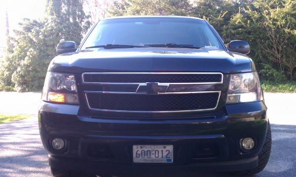

it will look like this

That's exactly the look im going for...how hard is it to add the resistors?
