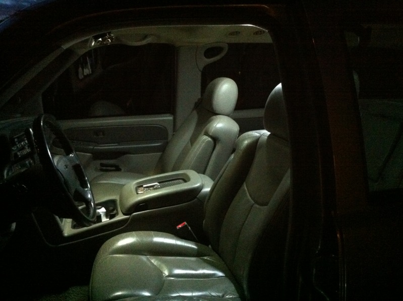

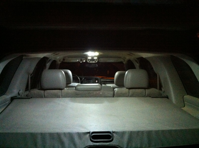

just finished mine up the other day. i'm really happy with em. they're brighter than my cell phone pics show too
heres what i used. cost about $40 total. gave me enough bulbs to do the plate lights, all four doors, map lights and all the overhead lights.

Map lights are the 2 directional ones at the very front. The dome lights are the ones in the middle and back of the truck that turn on with the courtesy lighting. There are also 2 switched dome lights per unit (4 total) that come on with the switches on the domes. The dome and the switched dome bulbs are all the 42mm festooned. I used the expensive high power ones for the automatic domes, and the cheap, non-SMD for the switched, since I never use them anyways. The map lights are the 194-base, just like the doors and license plate. And the puddles are also 42mm festooned. Get the high-power ones like the domes, you'll need the brightness.
So, if you were doing everything, here's what you want:
7xWLED-x-x (4 for the doors, 2 for the license plate, and 1 for the glove box)
2xWLED-x-6 (for the map lights)
4x4210-xHP6 (2 for the domes, 2 for the puddles)
2x4410-x9 (for the switched domes)
You could probably spend a few bucks more for the SMD-type, like the regular domes, only the 3-LED instead of the 6. In retrospect, I wish I had done this, but oh well. Like I said, I never use them.
And that's it. Did that help?
EDIT:
I guess while I'm at it, I'll post some pics for ya. I also did the footwell LED strips in the front seats. Still gotta find time to do the backs, but other than that, I'm pretty much done with LED swaps. Also, didn't include the license plate light pic because the street lamp behind me made the colors look totally different than how it really looks.
