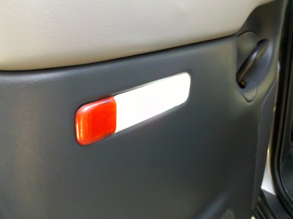

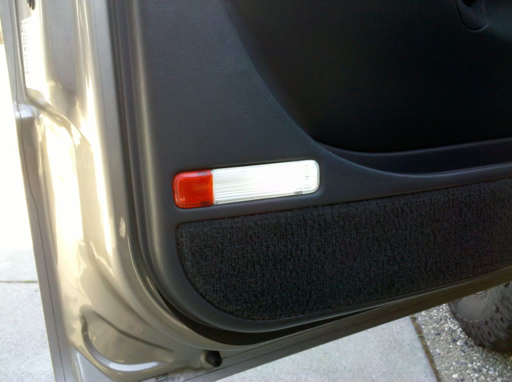

01 Suburban LS
Jul 9, 2010
I just took one of those stepper drill bits that look like a christmas tree and slightly enlarged the hole on the door lamp housing.
Used these bulbs.
chauncey0337
Jan 22, 2011
3,178
32
MLT, WA
Used these bulbs.
Nice. I like the look of these better for the door panels. Found them, $8.50 for two!
