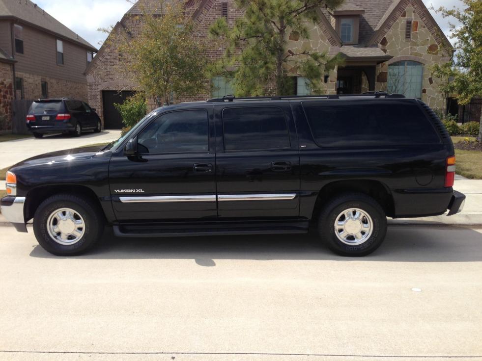

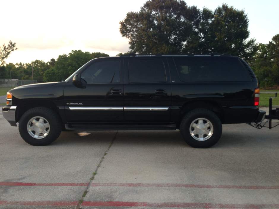

I also went with some different OEM wheels that I liked better. Here's a before and after.

Before w/Stock 265/70 R16s:
Front Left- 34"
Front Right- 34.5"
Both Rears- 36"
After w/Stock Tires:
Both Fronts- 37"
Both Rears- 38 1/4"ish depending on what the Nivomats decide to do on a given day.
The 285/70 R17s added another inch to those "after" measurements.

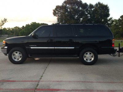

This is the only one I have on me. It looks the same, just 1" higher in the rear.
