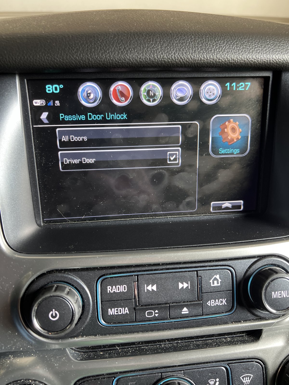

If it has the button in the door handle and it’s locked, the only way to unlock is with the fob, pushing the button, or unlocking from the inside. Your model does not have the feature to unlock by proximity and ONLY pulling the handle.
Check settings here
Check settings here
