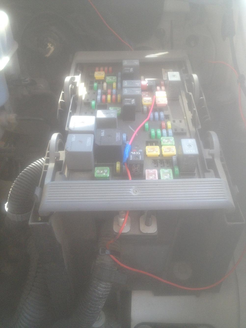

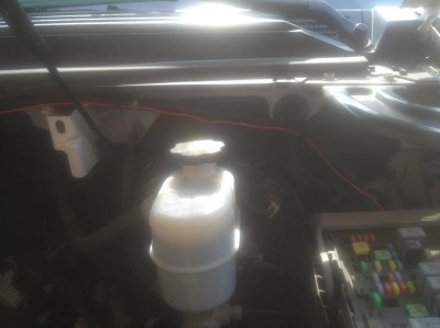

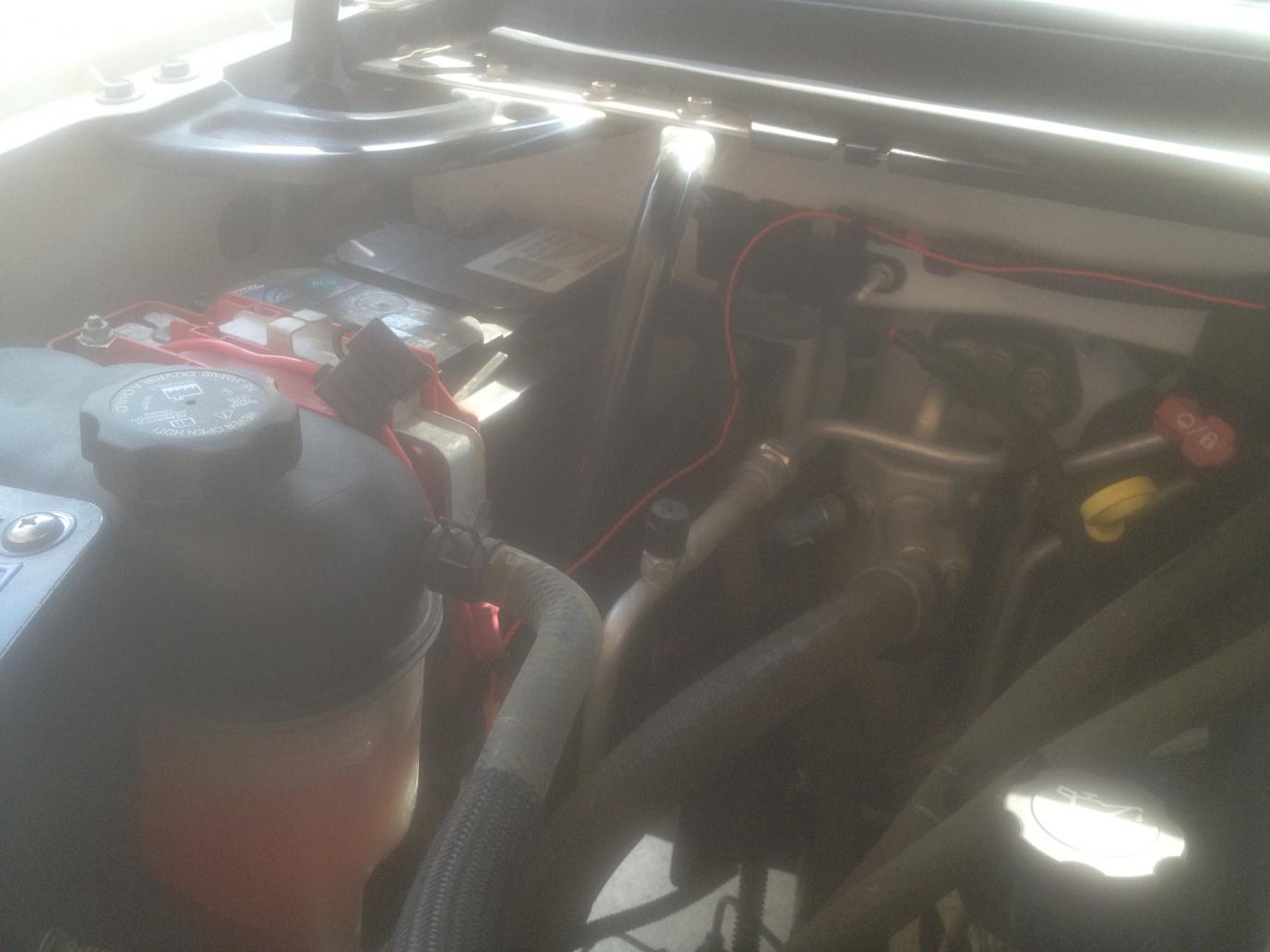

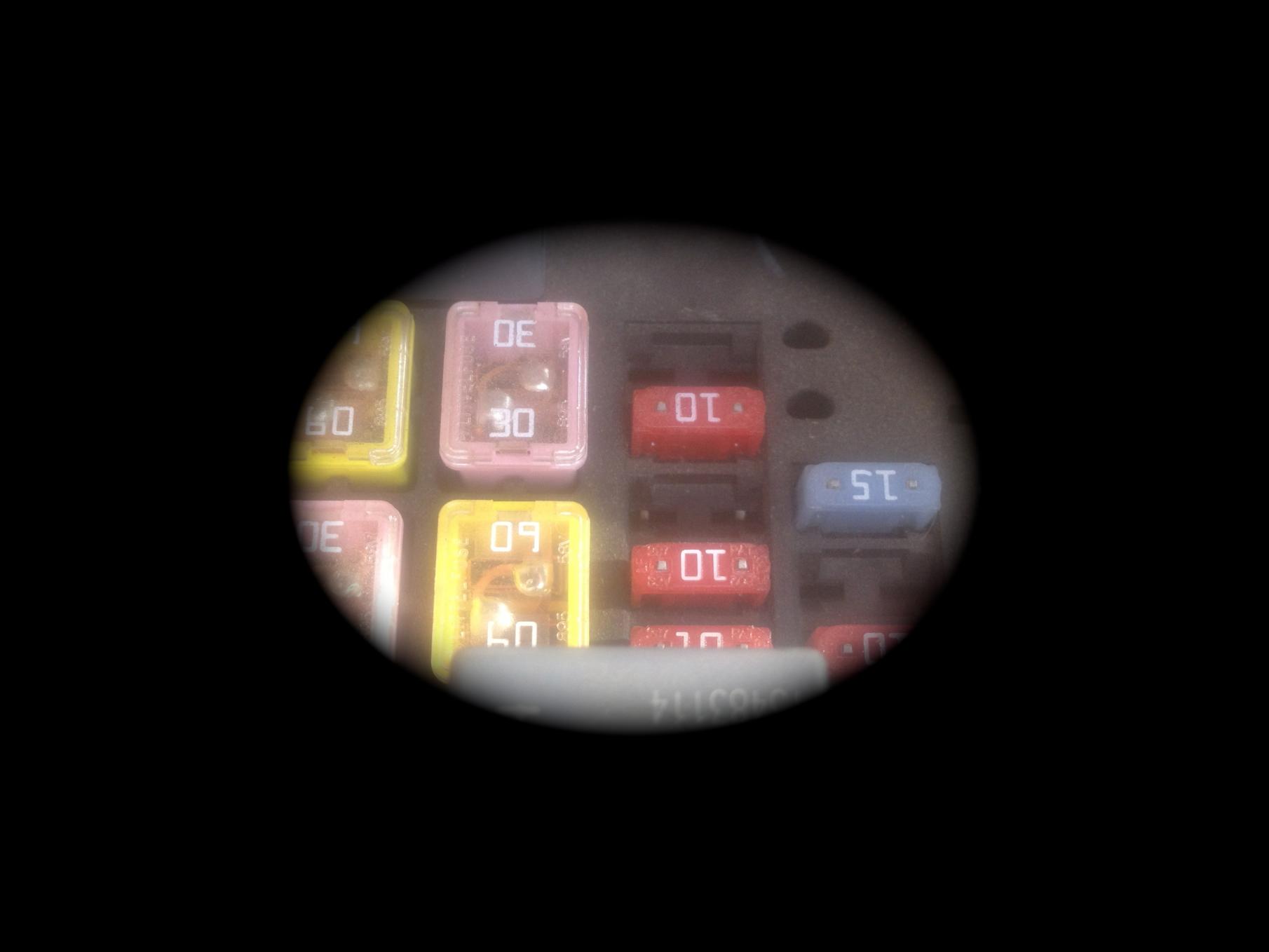

So I got everything wired up today. I used a test light and found that fuse #43 (MISC ING (10A)) was a keyed hot wire. I decided to use this fuse and put the add a line fuse holder "fuse tap" on it. Ran the "remote" wire out of the fuse panel and around the back and alongside the fire wall to the passenger side of the truck then down to my pressure switch. Everything works fine and as it should. Now all I've gotta do is clean it up with some wire loom. I ran out of the small stuff and wasn't about to use the big loom that I have on a small remote wire.
Modded, big props and thanks cause I didn't even know these fuse taps exist until you gave me the link.
Sorry for the small attachment pics, I don't know how to post the big pictures yet.
