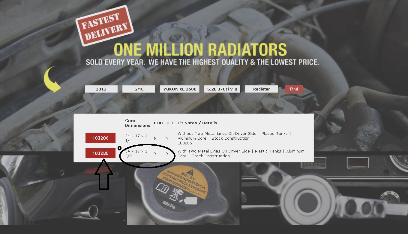

I bought this one from 1800radiator because it is 1/4" thicker, has both engine oil and trans cooler
