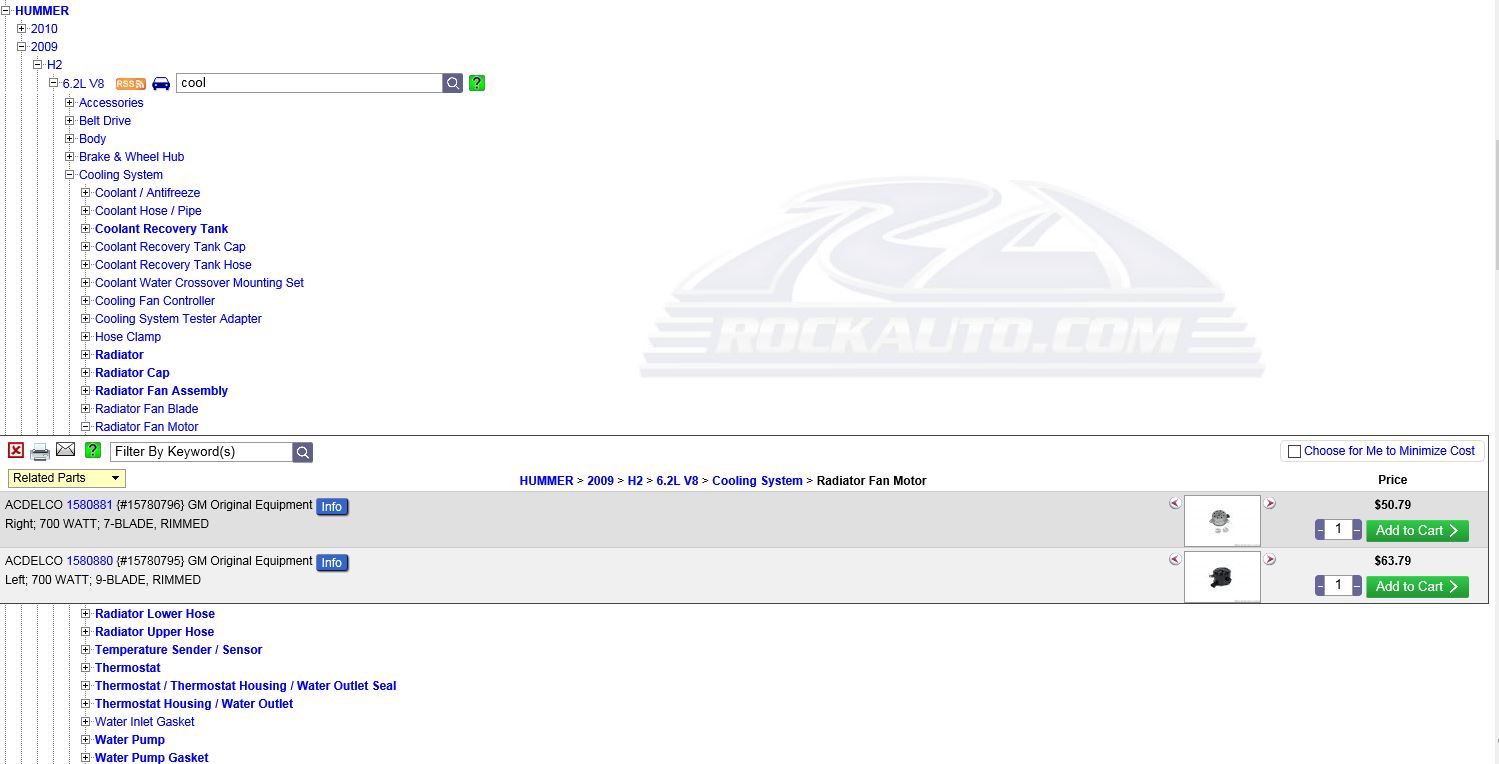

So the 7 blade and the 9 blade use the same 700 watt motors?
Did you install the 9 blade fan on both sides of yours?
I thought mine was the dual 9 but I just checked and it is the 7/9 like those I linked and the motors are correct, rockauto does not show another motor option
***7/9 so far I cant find a right side 9 blade option, yet it seems to be listed in compatibility list's

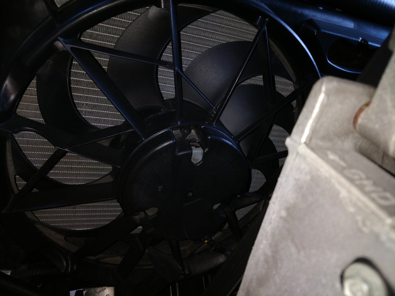

I think there is something different just not sure what because I would have just done the same while I was putting it together, I'll have to get my tape measure and check or if you have a 7 and 9 rimmed fan laying around measure the diameter and look on the backside where it mounts to the motor, the 7 blade has 7 slots on the back and 9 blade has 9 slots on the back that might be what it was or the motor fitting that it goes on was different.
