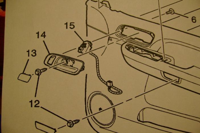

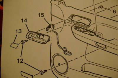

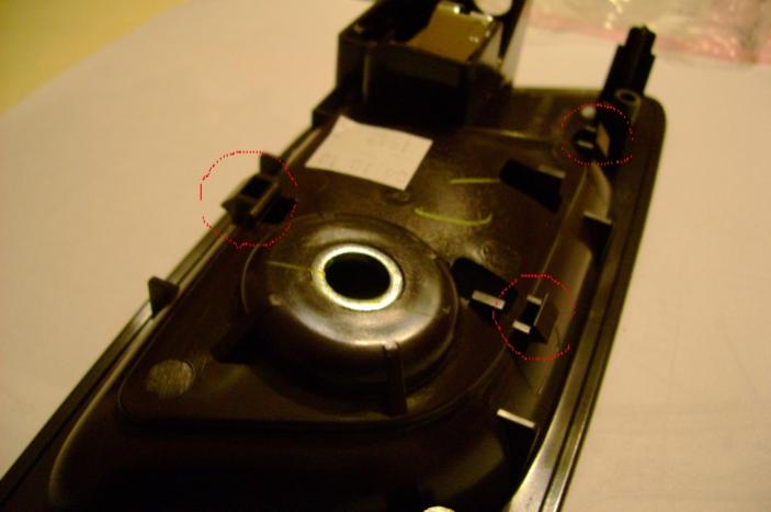

Noticed the right front inside handle peeling about a day after buying our '07 Yukon D. It was "very" small at the time, and I just happen to catch a little reflection. Of course, I've picked at it a little since then. I bought the new door handle a few days later, and of course "then" decided to check here. I really didn't think this would be such a widespread and talked-about item, but have found lots of discussion here and many other forums/sites.
Apparently the repair kit is just $12 (per the above post, and other sources), includes 2 chrome handles and 2 new pins (why the pins?), whereas the handle from the dealer is the whole handle, and its parts cannot be ordered separately, and cost $125 (see attached pic). I was thinking about just replacing it myself, now that I know how the assembly is attached to the door panel (see 2 pix - there are a lot of protuberances, but only 3 are the clips that go into the door panel), but GM might not want to reimburse me for the whole handle assembly, if all they're really replacing is the chrome piece and a pin.
