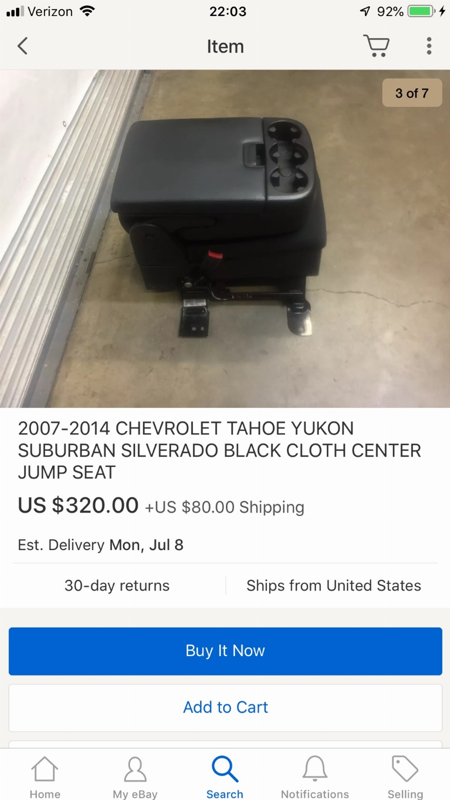

Hey guys I just picked up this center jump seat but I don’t have the mounting bracket. It’s for my 09 PPV
Any suggestions ??

The bracket is part of the bottom jump seat. all you need to do is remove both driver/passenger side seats and place in the jump seat then put back driver/passenger seats bolt them down and your done.

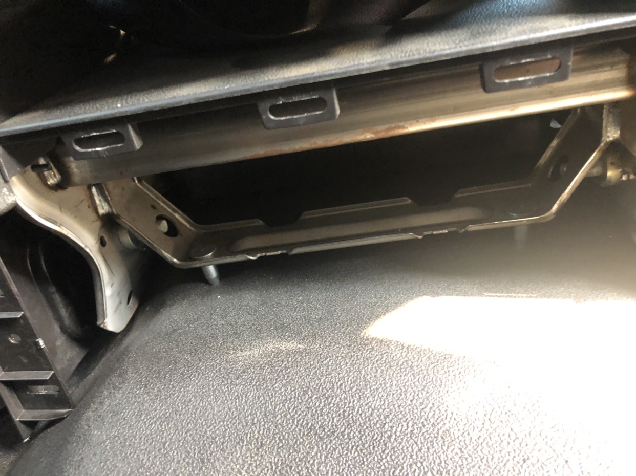

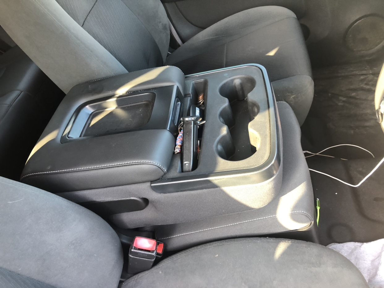

Ok so I finally got the truck back from the body shop. Here is pictures of the console
It looks like there are bolts on the bottom to attach to some bracket

Isn’t that a jump seat that’s already in there?

It’s just sitting where the police console was it’s not bolted down

Ok...but the first post shows a black jump seat, but then this pic shows a grey jump seat that matches your interior. Which one do you have, because the black one has the normal mounting brackets that attach at the seat bolts.

I have the last picture Of my actual interior The generic pic from the beginning was incorrect

Oh ok. We need to see the actual jump seat turned upside down so the brackets (or lack of) are visible.

Looks like you have the jumpseat off the 15+ Tahoe. Mine looked like the first pic you posted from ebay. Thats probably why its not bolting up correctly

I dont think the brackets are removable on yhe nnbs jumpseat..when i sold mine last year it was a pain to ship it via fedex cause i couldnt find a big enough box to ship it. Ended up cutting a box down to make it fit with the bracket sticking out

My 2010 had a 2015+ for a while. Some bent sheet metal to mimic the 07-14 style welded to it worked like a charm.
