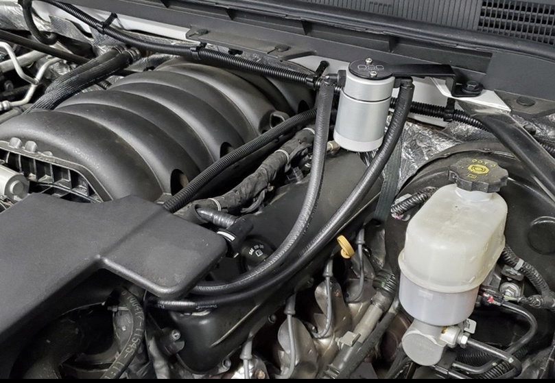

Got one of these cans and the extension for our 2019 5.3 Tahoe. Need to put it on soon but have a question for those that have them.
From the pics I’ve seen, the hoses look to be routed right in the way of the oil fill cap. It’s enough of a hassle trying to keep a funnel in position while filling with oil. Don’t wanna be fighting hoses at the same time.
Do you all find the hose location to be an issue or are the pics I’ve seen misleading?
Has anyone replaced the hoses with longer ones for better routing?

I have your exact same setup. The hoses are far in front of the oil fill cap the picture is misleading. Never had an issue filling the oil. The can catches a ton of oil too. Definitely worth it on these DI engines.

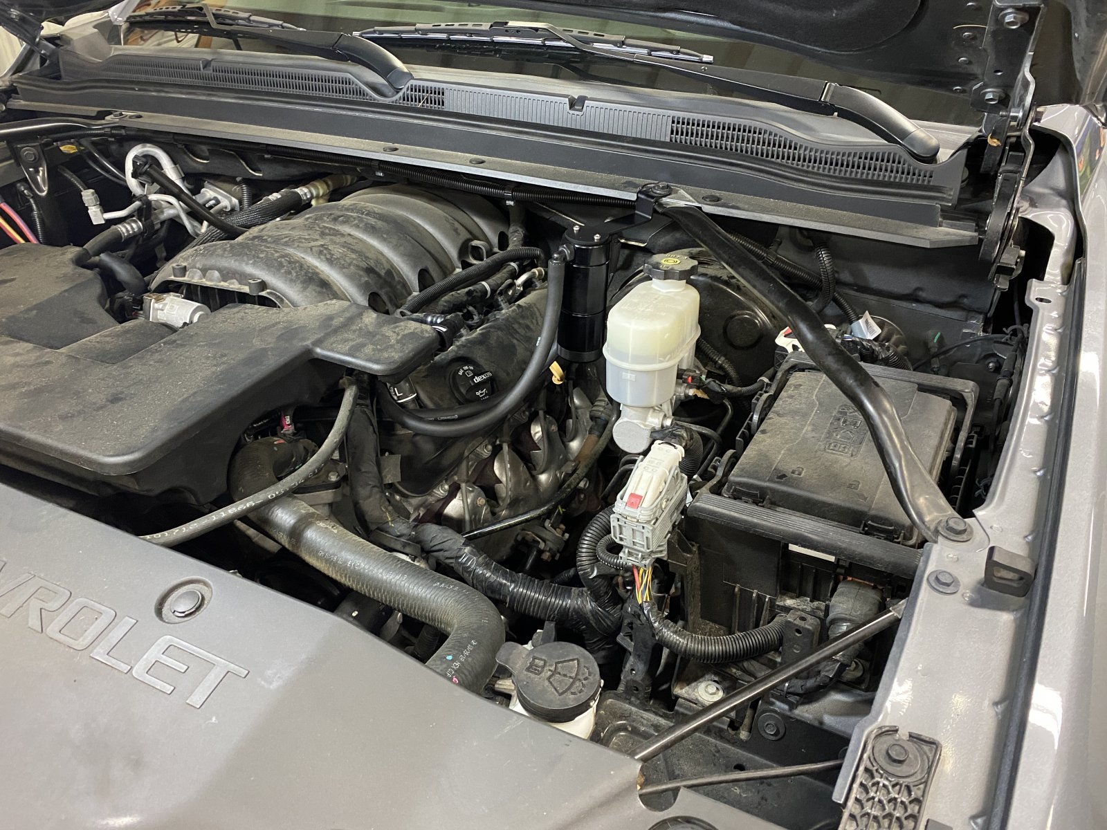

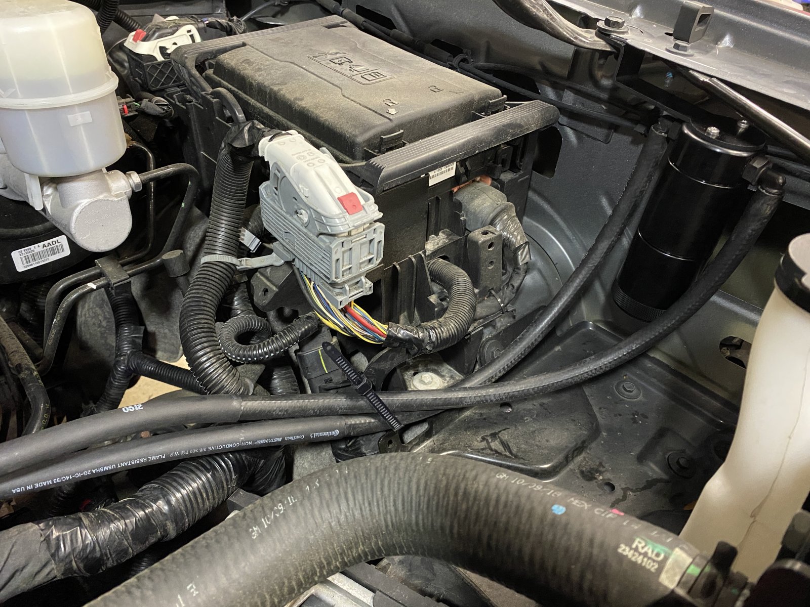

Installed the catch can today, and as I feared, the hoses were right in the way of the oil cap. Not sure why others didn’t experience this, maybe their hoses were longer or something?
I flipped the bracket upside down to get the hoses a little lower but it still wasn’t enough. With the bracket installed with logo up, the hoses had to be pulled aside jut to get to the oil cap. I have the add-on extension which made it worse I think.
I used 3/8” barbed brass couplers to extend the hoses and mounted the can at the opposite end of the fender brace, over the spare battery tray. This location seems like it will be much easier to service the can.
