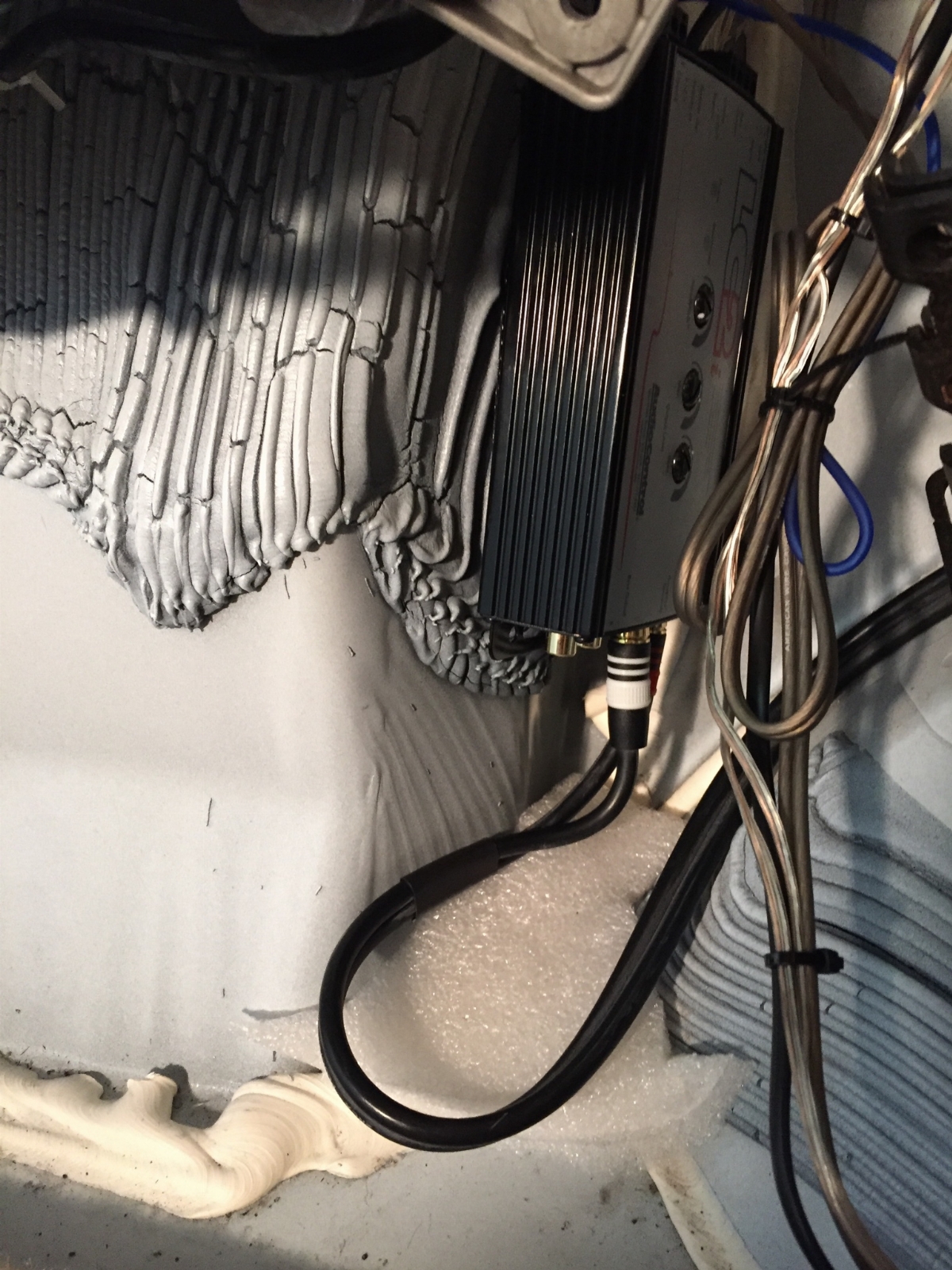

I'm also curious where others have mounted the amp. I see most have mounted it under the rear captain chairs, but I have Weathertech floor mats and I'm sure my kids will eventually spill something down there.
I have been trying to locate pictures of an Install where someone has placed the amp in the driver side cargo area beneath the liftgate motor, but I haven't come across anything yet. I have a JL JX500.1 amp that should fit well.

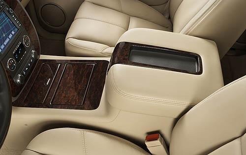

I think I'm okay. The site says it won't for trucks with vents on the console or those with a "deep" storage area behind the cup holders. Mine has the small compartment behind the cup holders, but I wouldn't say it's deep.
I googled some of the 2008 versions and this is what I found. I think this is what they're talking about
BlueAc
Sep 23, 2016
66
22
Yea that's the same console I have and I purchased the stealthbox for it as well. Judging by this pic I'm guessing the seats have to come out to get the console out???

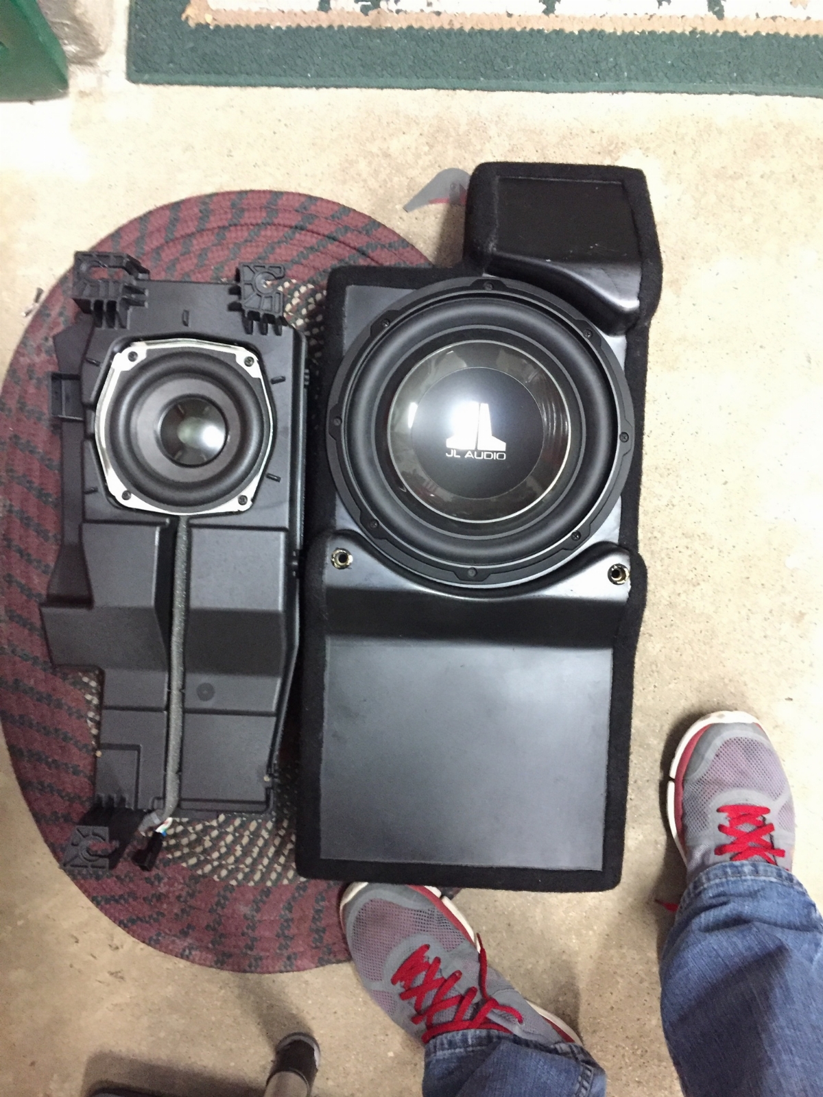

Meccanoble
Oct 3, 2016
1,166
355
Georgia
10's are naturally built for accuracy I would imagine. I wonder what is the best 10 for SPL that would fit in that enclosure. Your upgrade looks awesome regardless.
