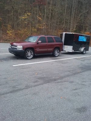

After being ripped off by a bad engine builder and my 5.3 giving so much trouble it finally gave out on me last week on a trip pulling my enclosed trailer to WV, 455.00 tow bill for 135 miles! She still runs but I think it warped the crank after the oil boiled.
I've been talking to a engine builder that has a great rating, haven't found any bad comments about him so hopefully i'll have him start on my build, i'm going with a 6.0 stock build, only thing i'm changing is flattop pistons and a small cam, long tube pacesetter ceramic coated headers (PSM-72C2266), y-pipe (PSM-82-1176), maybe a 2200 stall, and of course BlackBear Tune (waiting on them to msg me back on fb), i've heard so many good things about them and I trust they will do a great tune. Depending on how she runs I might upgrade my exhaust from me current 2.5" to a 3.0". If I am missing anything please let me know, pics will come once the shop picks my hoe up. While the shop waits on the new engine to come he will also be installing my 2/4 lowering kit. 12193508_10208746581919855_5078441036065510594_n.jpg 12187841_10208743289997559_1840204759428837296_n.jpg
