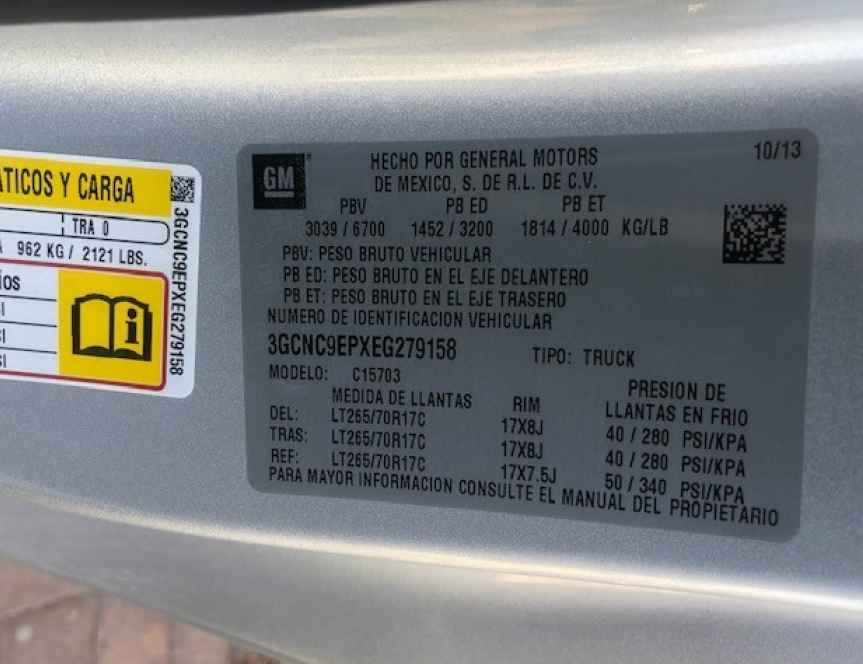

I've spoken with someone that has a GMT900 pickup that they said they swapped. Didn't get into too much detail, but said they used all GM800 parts to do it.
They did make a Mexican GMT900 pickup, but they only put the manual behind the v6. I even found a GMT900 3500, and it had a manual with a v6.
Years ago, I even found a guy selling a K2XX reg cab pickup with a factory manual transmission, in Las Vegas. It had a mexican plate on it. I asked, and he sent me the VIN. I've posted this a few times, and never had a response from anyone that has tried to look into the parts that way.

strutaeng
Aug 10, 2023
1,766
3,838
Dallas, Texas
Yeah.. Pretty sure it was a dually too.
Looks like the gvwr is "only" 6700 lbs. The PBV number, in units of pounds. That sounds more like a 1500 series chassis, no?
I would imagine a 3500 DRW would be at least 10,000 lbs for truck in this generation, even non-US market.
