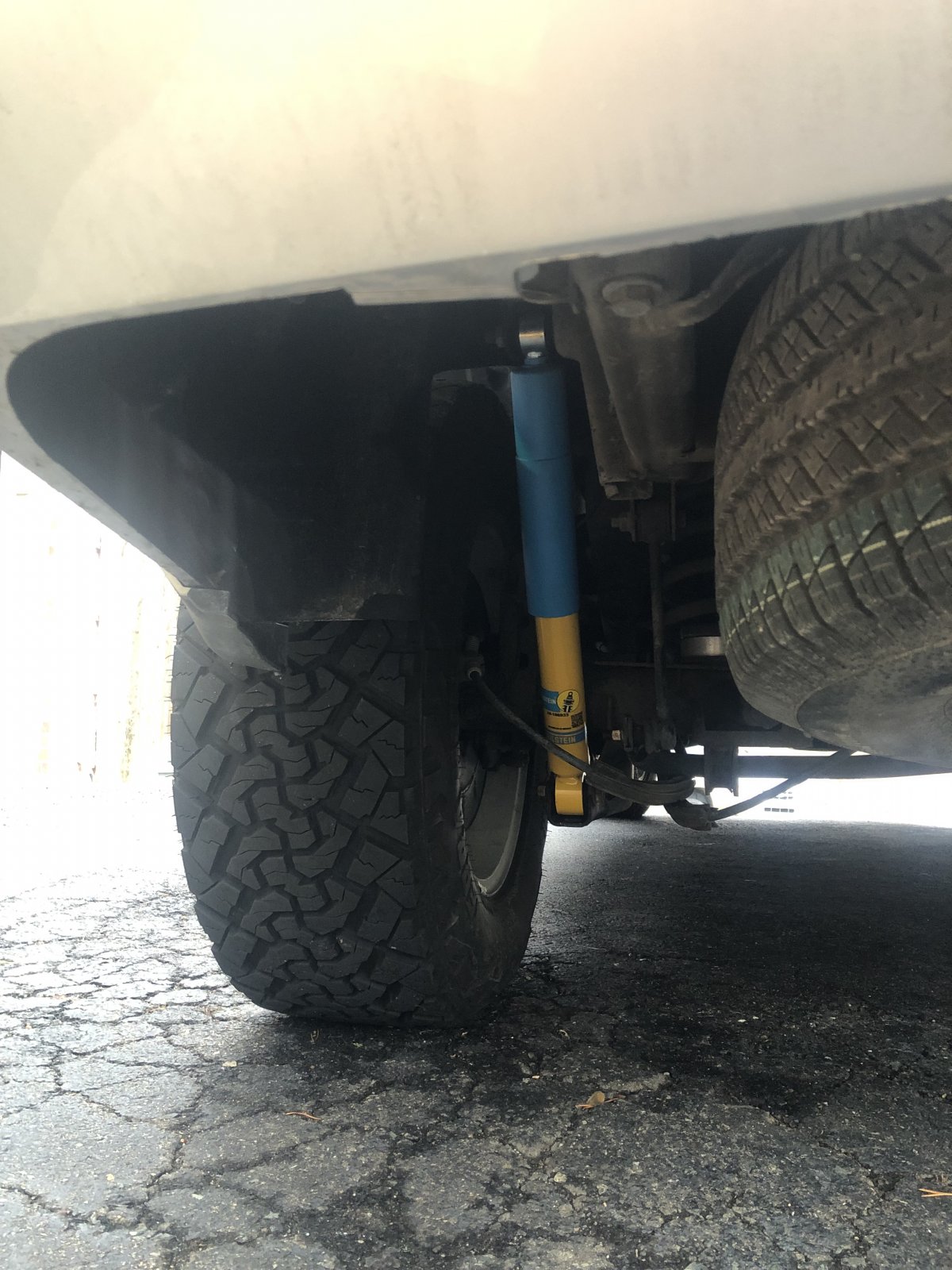

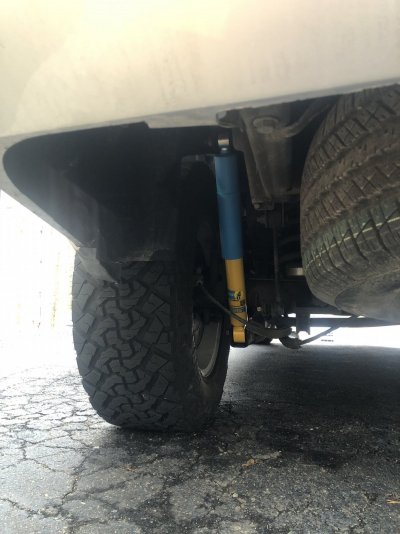

There are many types of lifts. To spot the simple ones, poke your head under the rear of the truck and look for any type of spacer that sits between the axle and the spring. There is a spring perch that holds the spring in place, but you are looking for something thick.
Same goes for the front, there could be a spacer on the top of your strut, or spacer between the bottom of strut and lower control arm. I’m not sure how to spot the more complicated lifts, some one more experienced will need to chime in.
I suspected my 2011 was lifted but it wasn’t until I got under the truck and took photos to compare to a stock one that that I was able to confirm

If you zoom in, you can see a silver spacer that sits under my rear spring. Probably only 3/4 -1 inch, but enough to get clearance for 285/70/18
