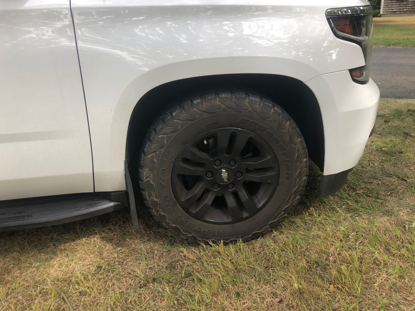

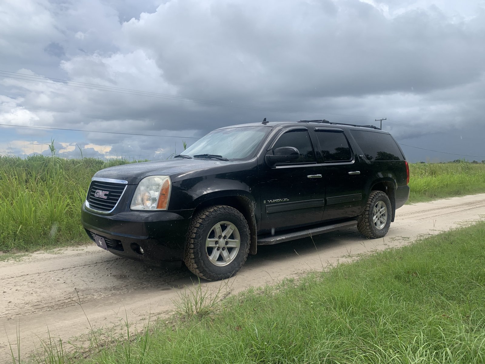

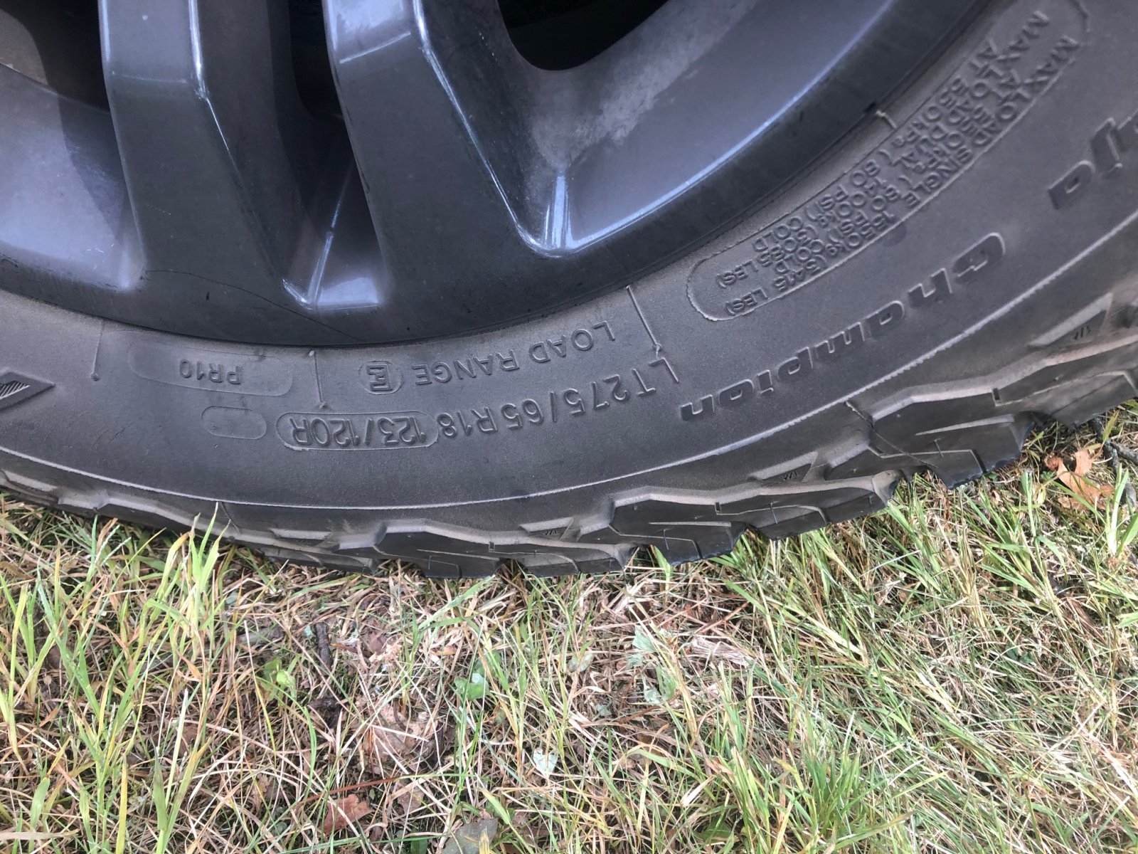

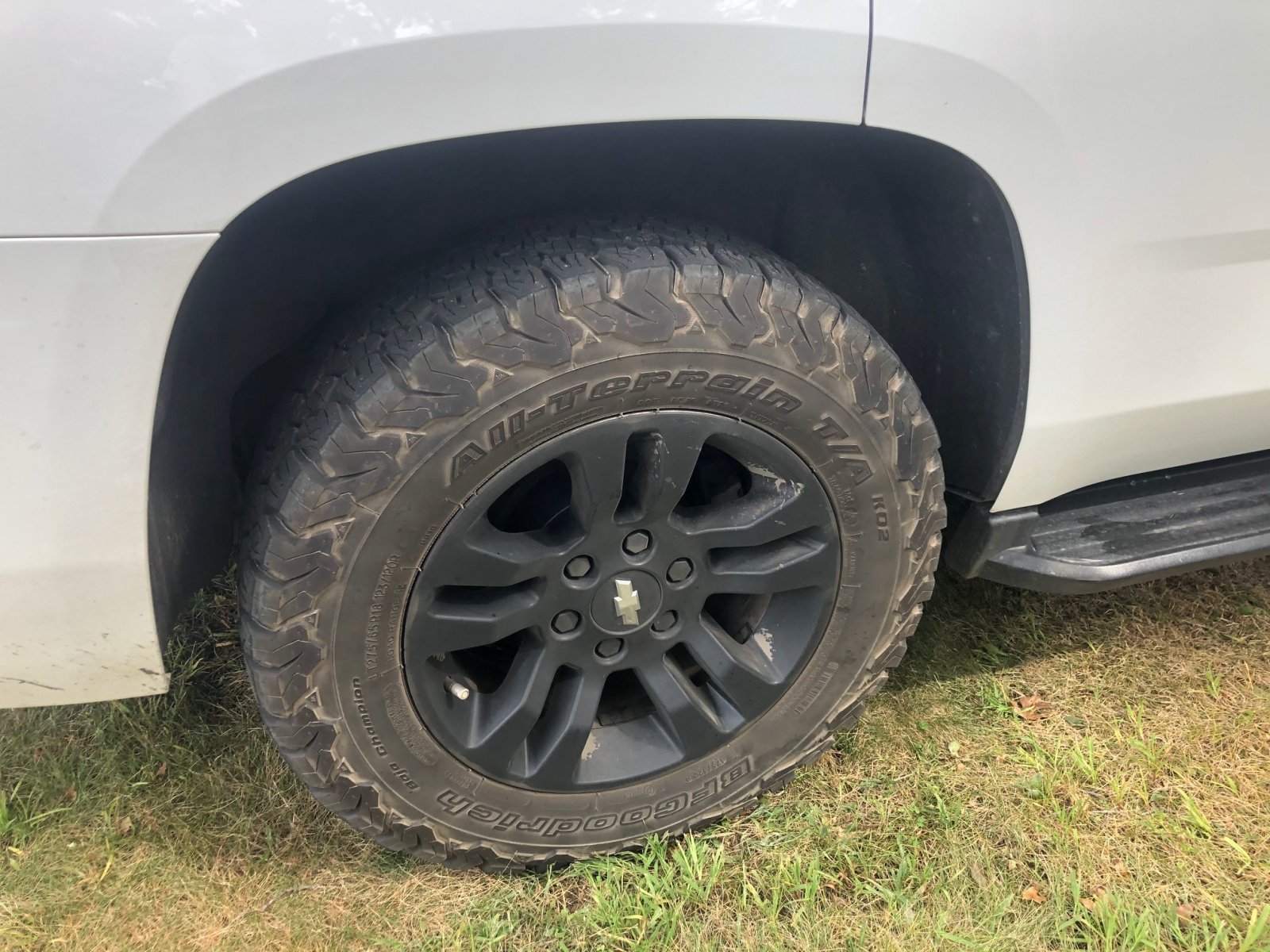

Im running BF ALL TERRAIN KO2 275/65/18 on stock rims. Im also lowered 2" in the rear and 1" in the front. No rubbing. Amazing tire. Looks so good. Sorry a little dirty.
