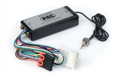

Sorry guys, guess I'd missed the latest questions on this thread until now!!
It's all pretty simple, just pop out the stereo/gauge trim, then I believe there are 4 tabs that you need to push down on the stereo to get it to release and to pull the stereo out, then there should be 2 harness plugs going to the back of the stereo. All I did was pull the out the black plug with red top from the stereo and install it into the white harness plug on the pac unit, then take the black plug from the pac unit and plug that into the stereo and your done!! All you need is a 2 wire RCA plug for whatever signal you want going through the pac unit for the sound to work. Hope that helps!!
so pull out the plug that looks like the one on the unit, plug the unit plug in and attach one of these: http://es.ucables.com/img/extra/35MM-18-MINI-PLUG-TO-R173481-0.jpg and feed the wires down somewhere?

Yep, just like how I described except there are ony 2 tabs holding the stereo into the cradle in the truck( I just took mine out tonight to add another RCA plug wire to the Aux 2 side of the pac), just push down on them at the same time and the stereo should come straight out!!
As for the link to the wire you posted, you will need the male RCA plug version instead of the female version which is pictured in your link!!

Sorry for all the questions, but i have one last one. Where did you put the unit once hooked up? did you tuck it into somewhere, or just let it hang? And where did you feed the toggle switch and auxillarly jack wire out through?

Also SP543, when you pull your stereo out you will notice that there are 2 square good sized holes at the rear upper part of the plastic stereo cage, all I did was hook up my RCA's to the Pac unit and then was able to tuck the unit into the hole out of the way of the stereo!! Worked perfect!! Feel free to call me if you get hung up on any part of the install!!
