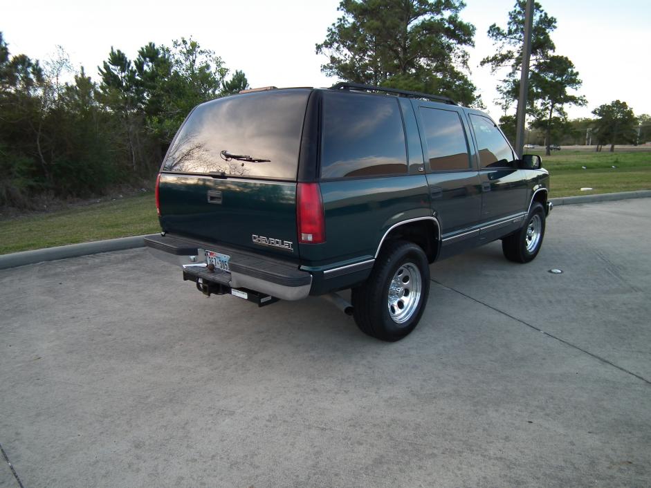

I've had this Tahoe for about 2 years now. It has about 160,000 miles and I had the trans rebuilt and pulled the engine shortly after I bought it because it did the ol 4L60E bang shift. I tore the engine down to the short block but there was still crosshatch in the bores. So I installed a new oil pump and timing chain, bought a gasket set and the MPFI conversion injectors. I went from 13 to 16 mpg afterward. I went crazy and replaced all the accessories and drive components minus alt and a/c comp., which looked new when I bought it.
I drove it for the last 2 years but got bored and it was sagging in the back. So rather than lower it like I have done to nearly every other vehicle, I decided to go with a modest 2" Rough Country lift. It still rides good too which I am happy about.
One note about the lift, I bought new leaf springs for the rear (required partially dropping gas tank) but they were heavier duty than stock so I had to go down to a 1" block to get it level.

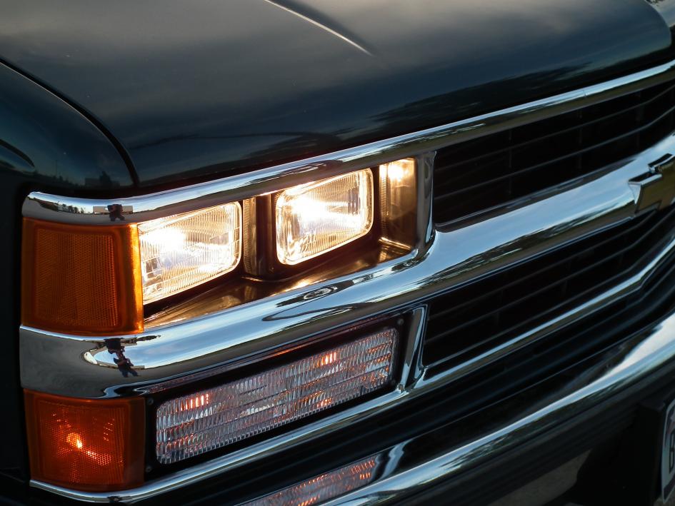

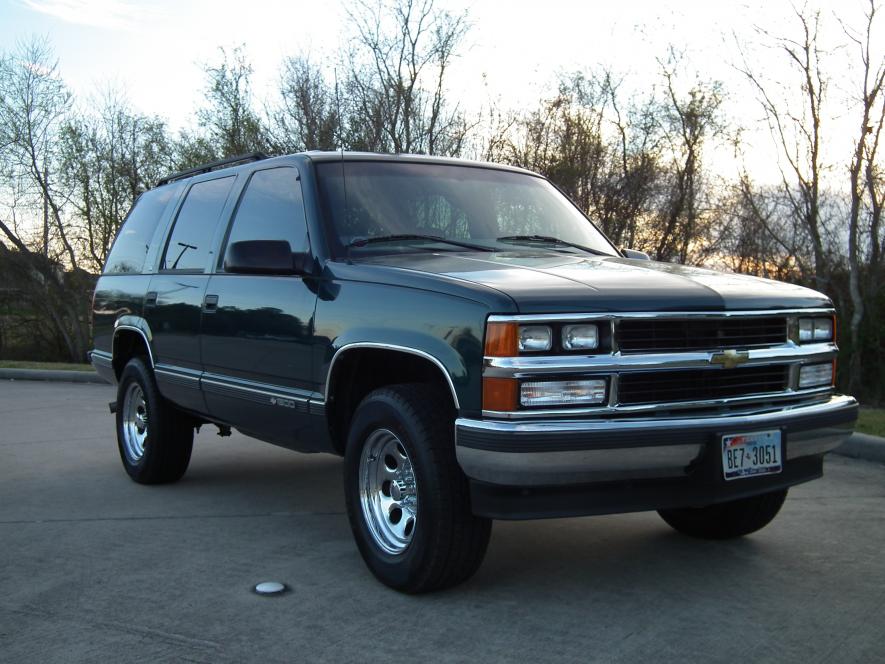

Next were the 17x8 Cragar Soft 8's and 265/70-17 tires. I was going to put the 88-93 grille because I had to have the 88-89 headlights but I didn't want to fool with the filler panel/paint. So I modified the lights and an aftermarket (super cheesy) late model grille to fit the sealed beams. Then i did the all on highbeams with power directly from the battery.
