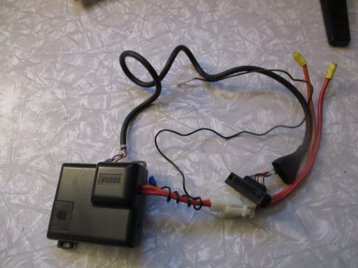

GOT IT ! But - what IS IT ?!?!? While installing a new ignition switch, found this. When holding in Start and nothing...hitting this caused it to start. Looks like some sorta starter interrupt. Taking it out = full start! Has "6900A" on it.

Ahhh...yes...there's a variable isn't it. Looks like maybe an aftermarket remote start or alarm unit. Must not have been letting an ignition signal through. Great that it is out and now you're starting and running!
