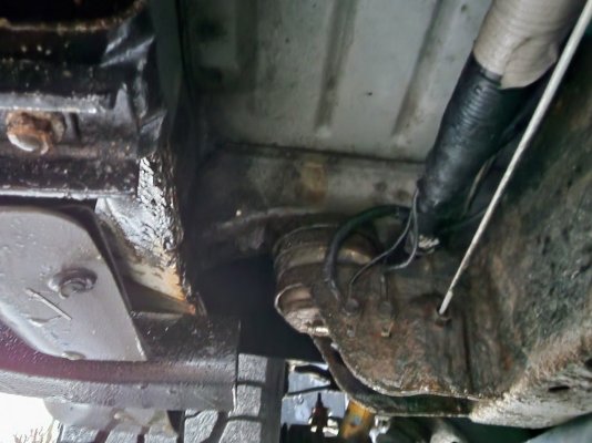

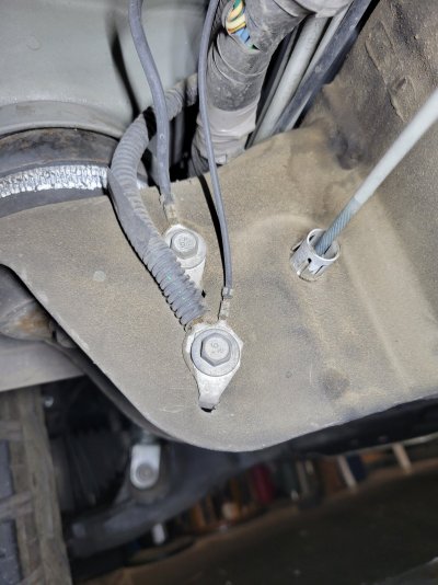

Wiring harness is likely rubbed through and touching chassis ground intermittently.
