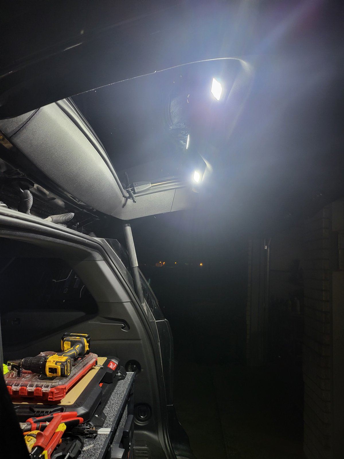

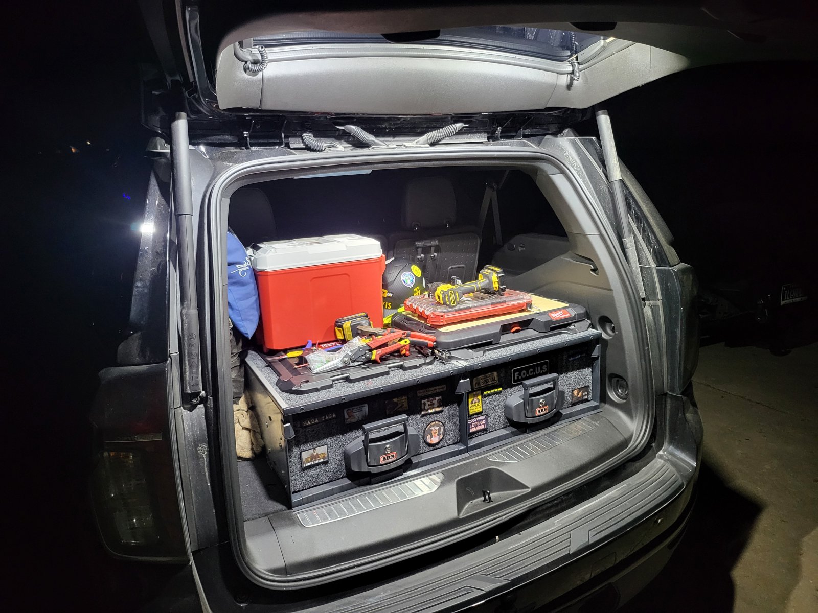

Installed 2 scene lights on rear door molding, and RGB rock lights as well to have access to red lights to illuminate area when needing a little less conspicuous access.

Those look great. I'm assuming something like this?
Did you hook into the power on the rear liftgate to power these? Are they switched or they come-on automatically?

Thanks
Yes like those style scene lights, used rigid and these kasper as test run on my equipment trailer deck, couldn't tell difference, between them. So opted for the Kasper cheaper ones,
Switched, and used a fuse tap on rear fuse panel F09- says not used and it's constant hot.
Kaper II L16-0209 Black LED Surface Mount Utility Flood Light, 1 Pack https://www.amazon.com/dp/B074DNDJM...abc_3CZJ48TDYDYZ30GPTN7Q?_encoding=UTF8&psc=1

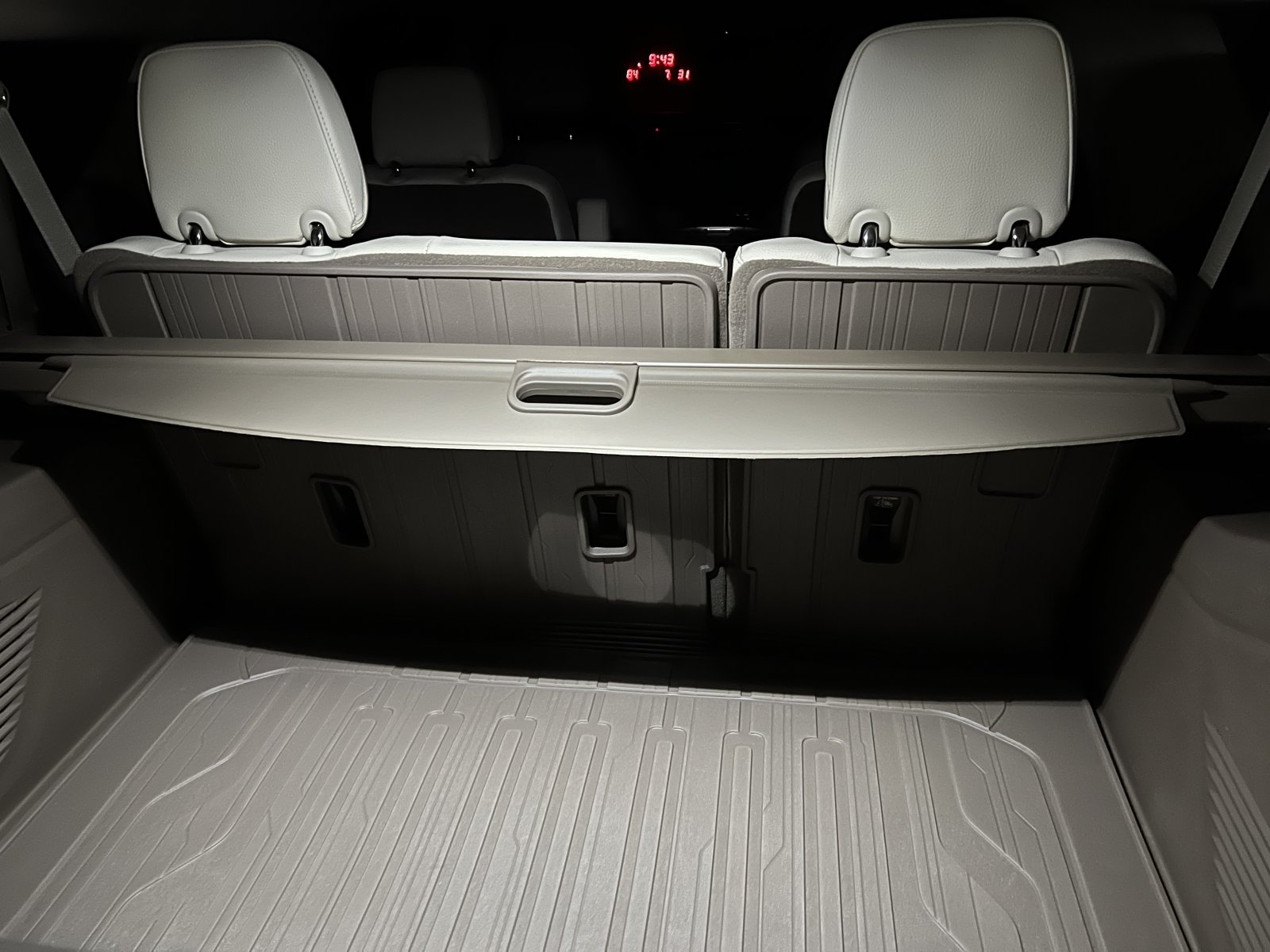

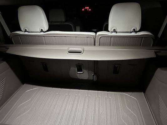

I don’t think it’s too bad…kind of prefer it not blinding when it’s dark out..

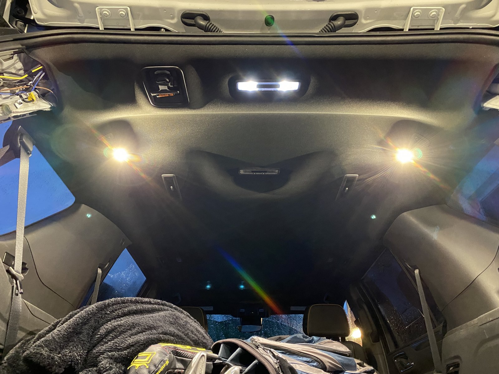

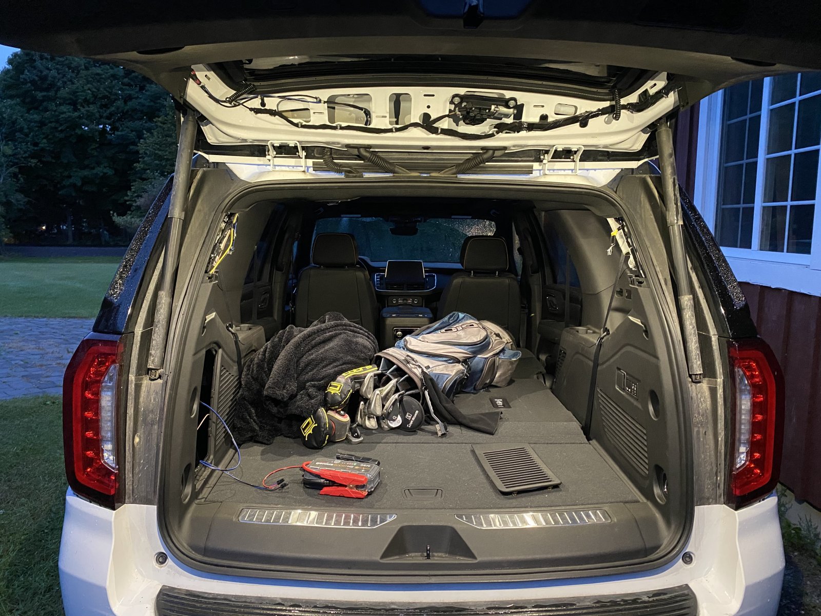

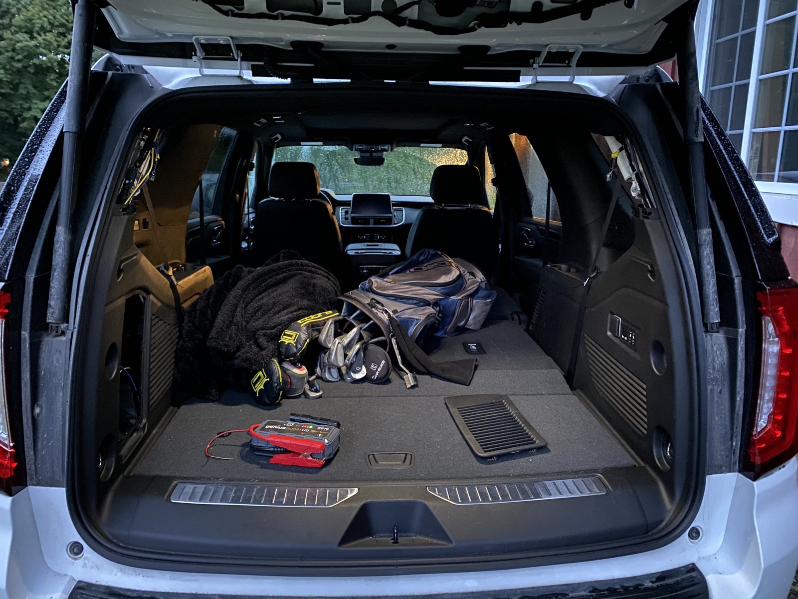

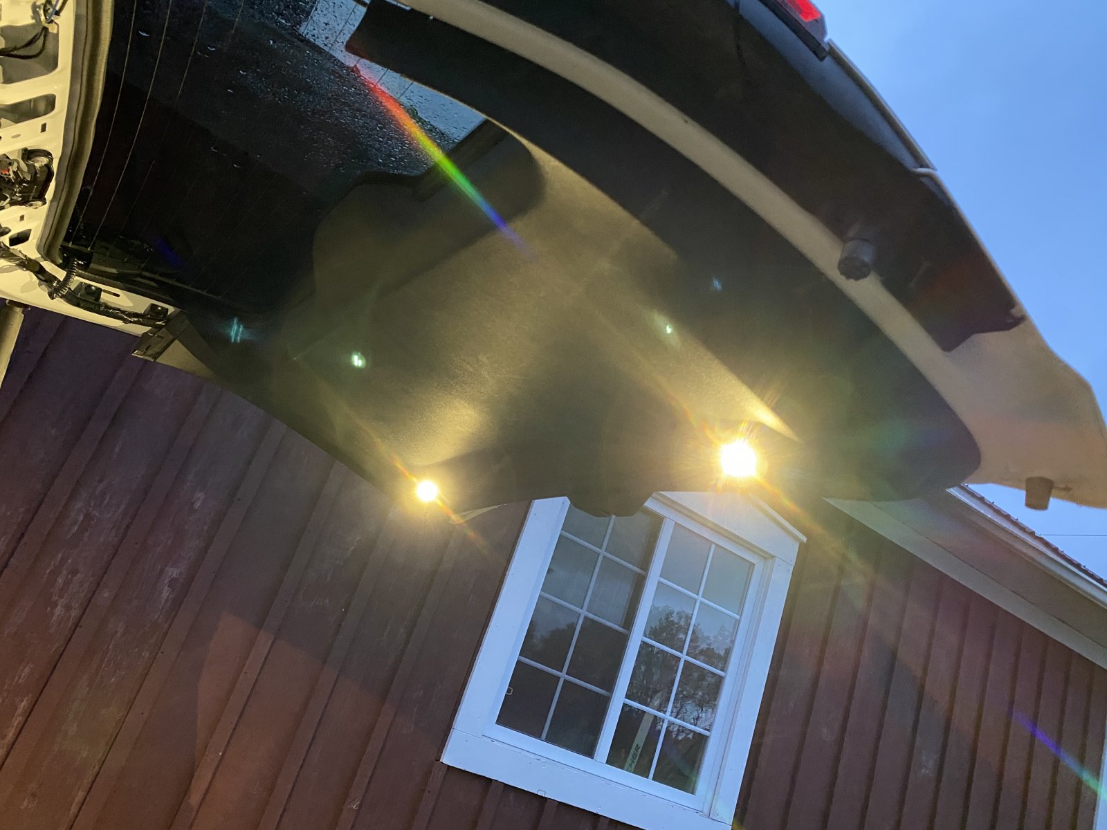

I have no complaints about cargo area lighting. Rigid A-series LEDs.
They're powered by a jumper pack in these photos but I did wire them into the rear cargo light via a relay (and transistor to counter the soft on / off of the dome lights) and replaced the trim.
