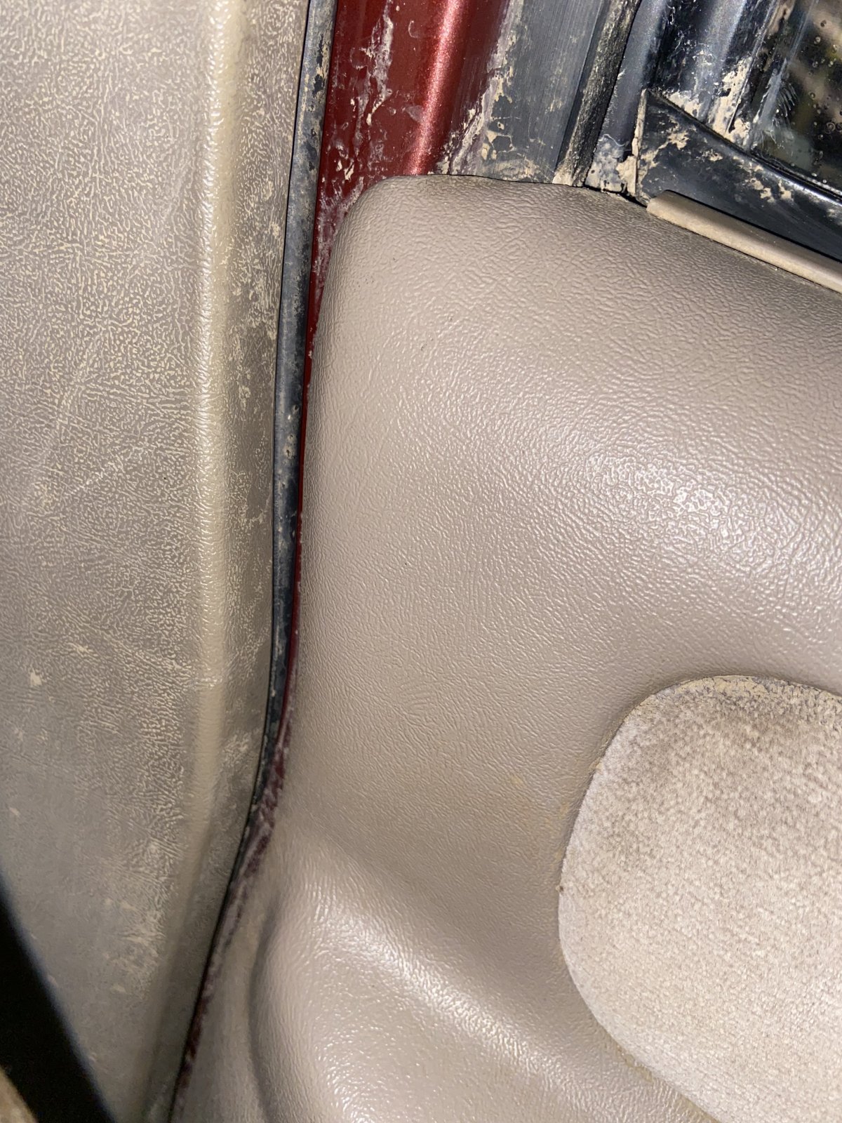

Have a picture? Are the gaps the same on the passenger side?
There’s a decent gap on all of mine (three 98s) between the panel and b-pillar.
Pardon the mud, this is my son’s truck…

I've looked at both trucks and your gap appears larger than what I have. Not much in the way of adjustment on these trucks as the hinges are welded. I guess if I get a chance I'll pull the hinge pins and replace them. Anyone have a good source for pins and bushings besides the Dorman Help stuff?

If your door is so far rearward as to impact the panel on the inside, I’d think that you would have next to no gap on the outside when the door is closed.
Is your b-pillar trim loose or is the weatherstripping pulled out?

No B pillar trim looks good and tight so does the weatherstrip. I will put some time in on it soon, too many other projects right now. 97 Tahoe wipers have problems, that's first. It's not the module, looks like the switch.
