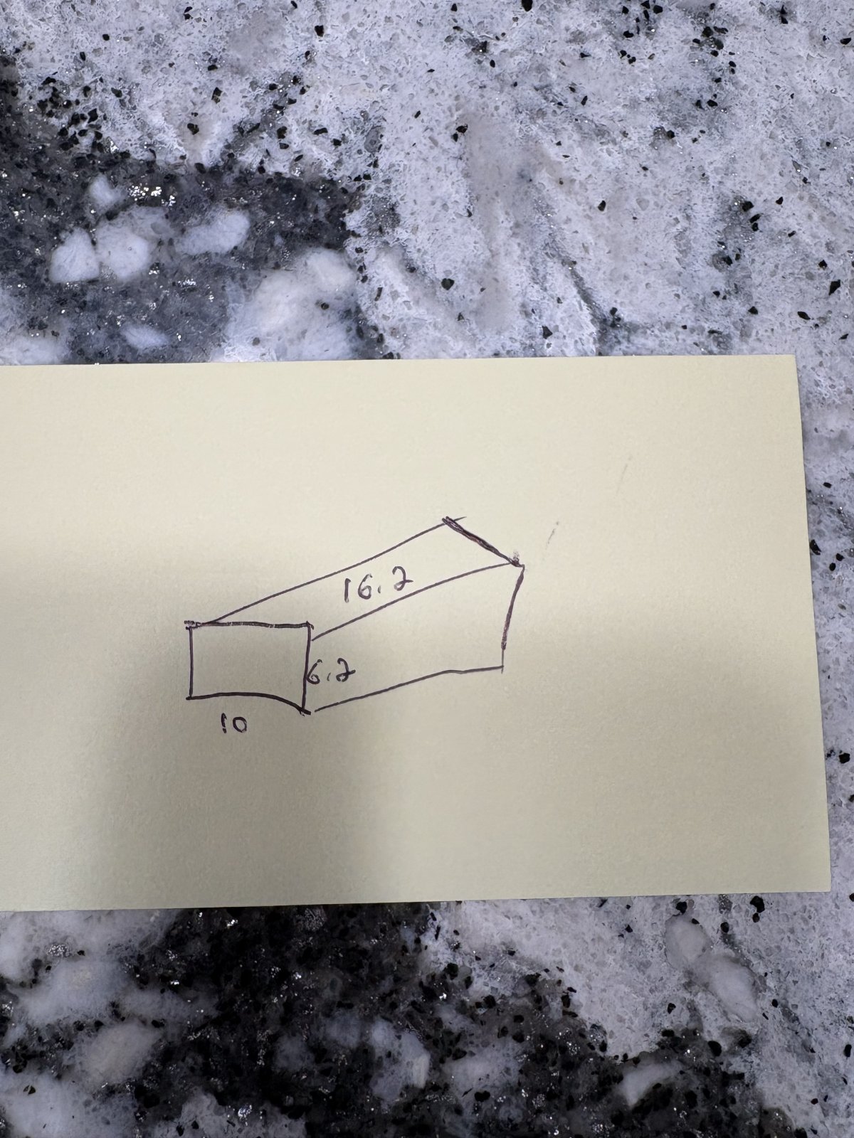

would this be the jist of it?
W 10 is my (1)
D 16.2 is my (1.62)
H 6.2 is my (.62)
I used 10 just because it’s a quick math number. But does that look like I’m going down the right path?
Terrible illustration below
Yes. Those specific dimensions yield 0.58 cu. ft. (outside dimensions), but you would want to calculate this volume based upon interior dimensions Now you can scale those dimensions up until you have an inside volume that is close to the optimal volume of the subwoofer that you are going to use. To make a good fit to your available space, or to make the speaker fit inside the enclosure, you can modify the exterior dimensions of the enclosure somewhat without sacrificing sound quality.
Sweet. I wasn’t exactly understanding what you said yesterday about ratios but the longer I thought about it, it clicked.
I’m always open to learning. I also had the same idea, I’m gonna scale up to 1.2 cu. ft. Internally. Then add some exterior filler since the space is pretty wide.

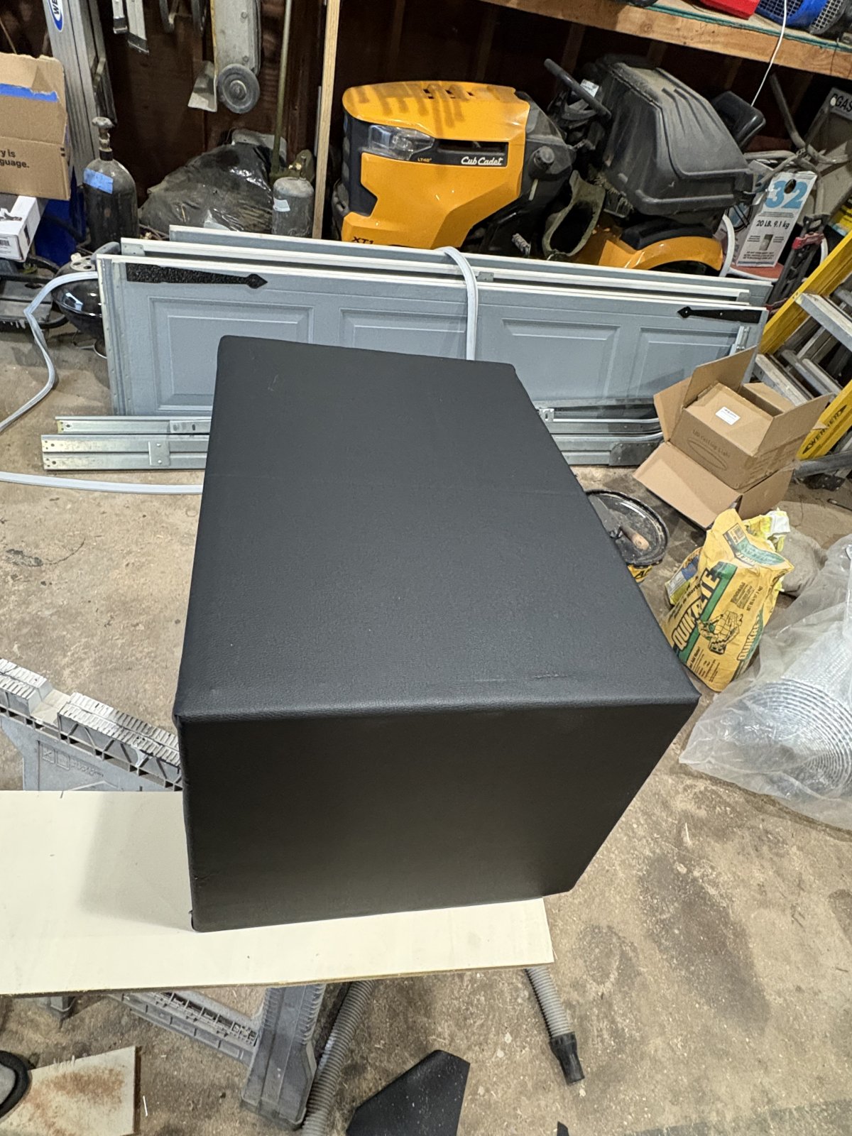

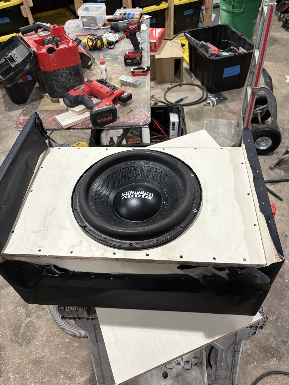

Well I made the box and I’m underwhelmed.
I think I’m going at this all wrong, I keep trying to save this sundown 12” sub that I have because I was once happy with it. The sub thrives in ported box, but whenever I put it in a sealed box, it just falls on its face…
Considering a kicker solo baric (that will allow me to reuse my box that I just built, would have to replace the baffle only)
Or I can scrap the box I just built and buy 4 more 8” subs that I just put in my van, im very happy with them
Pics just because
Pics just because

What are you powering the sub with? What is the sub's RMS and peak power capacities? And, what is the sub's optimal sealed enclosure volume?

feeding it with an old alpine mrp-m1000 (now that I’m looking at the specs that’s no good either) Was previously using a pioneer gm9701
sub says 1250 rms 2500 peak
Website claims 1cu ft not including displacement. Website does not list displacement I had to find the info elsewhere. Most people are claiming .14 for displacement.
I made my box
12.5 x 20.25 x 7.75 internally. 1.135 internal volume

1 cu ft sounds much more likely than 0.14 cu ft.
Are you saying that your Sundown subwoofer's power capacity is 1250 rms watts and 2500 peak watts? If that is the case, you probably need more power than your Alpine's 600 watts rms to drive that subwoofer for full sound capabilities.
My enclosure is roughly the same size as yours, but I have a 10" subwoofer in it. My AudioMobile subwoofer requires 400 rms watts to fill out its sound's capabilities, and my Rockford Fosgate amp is 500 rms watts at 2 Ohms, which is the impedance on my subwoofer, and the sound volume is plenty for me, and I like loud music (but not car alarm setting off volumes).

I should be getting closer to the 1000 rms at 2 ohms since I’m wired down to 1 ohm at my subwoofer leads. The amp doesn’t mention being 1 ohm stable though ( just noticed that), so that might be a recipe for disaster.
I am using the Low inputs as recommended by another user here with a LC2 LOC. the amp is tunable, but there’s no happy medium that I was able to find. It’s either tuned too low and the door speakers put out more bass than the box or it’s too high and just sounds like farts in a box. Not really getting any thump at all.
I think I threw this together too quickly and I’m trying to make an amp and subwoofer work together that just aren’t a good fit…

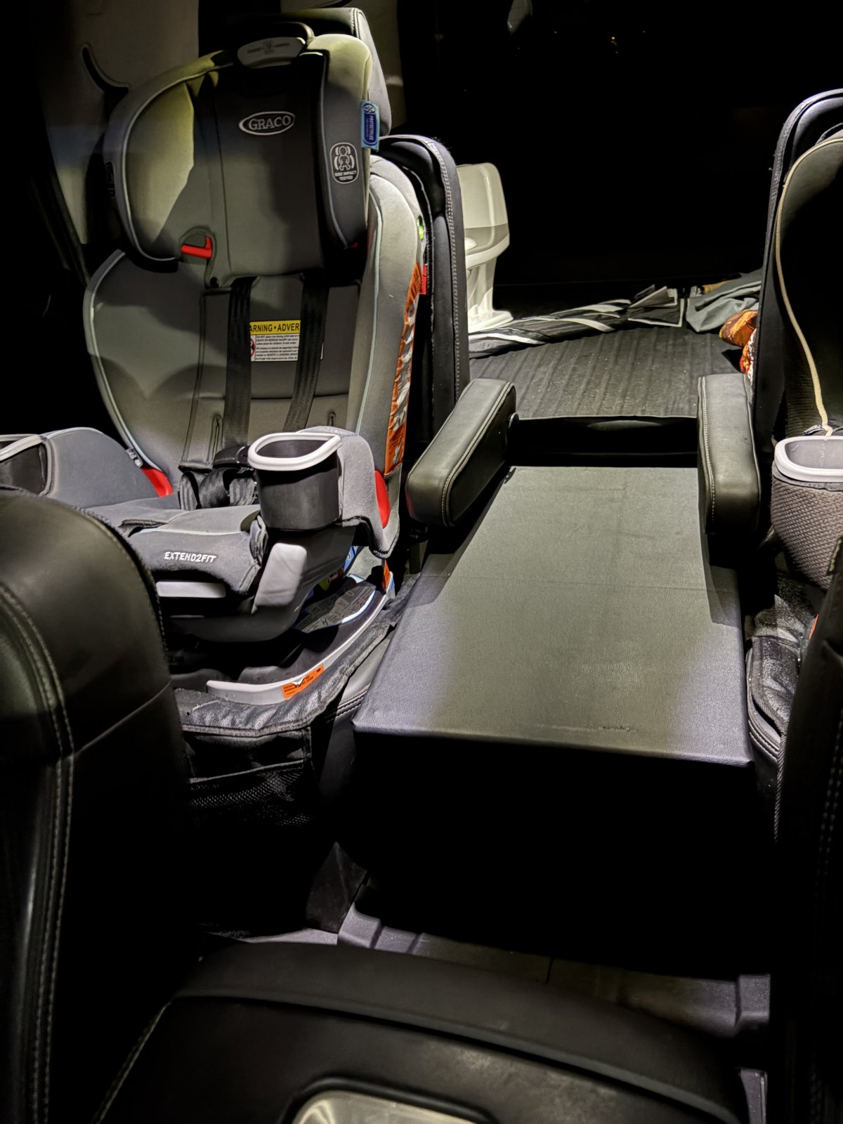

Do you have captains chairs for the 2nd row seats? If yes, I can show you a subwoofer setup that works for me with that configuration.
I have a 2026 Tahoe with the 2nd row captain’s chairs. Would your setup work for me, and if so can I see it?

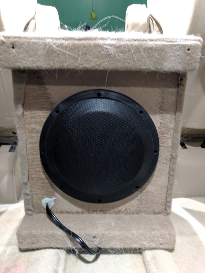

I don't see any reason why it would not work. You just have to build the box's dimensions, so that it will slide between the seats. The sub is freestanding, so that I can remove it, or move it to an other location in the truck, if/when necessary. The sub's speaker wire has quick disconnects to facilitate movement, and I carry a 10' length of speaker wire with the same quick disconnects, so that I can still use the sub, wherever it may be located within the truck. The amp is located inside the rear driver's side panel over the rear wheel, out of sight.
I used an American made 10" sub by AudioMobile, which specializes in making full size subs (not a pancake sub) that are optimized for small enclosures. The specific model that I used is equivalent to a JLAudio W3 in sound quality, a little less in full volume output, and it cost 30% less.

Please excuse all of the hair, as my White German Shepherds like to lay on top of the sub and look out the front windshield, whenever we go for a ride together, which is pretty much always.
