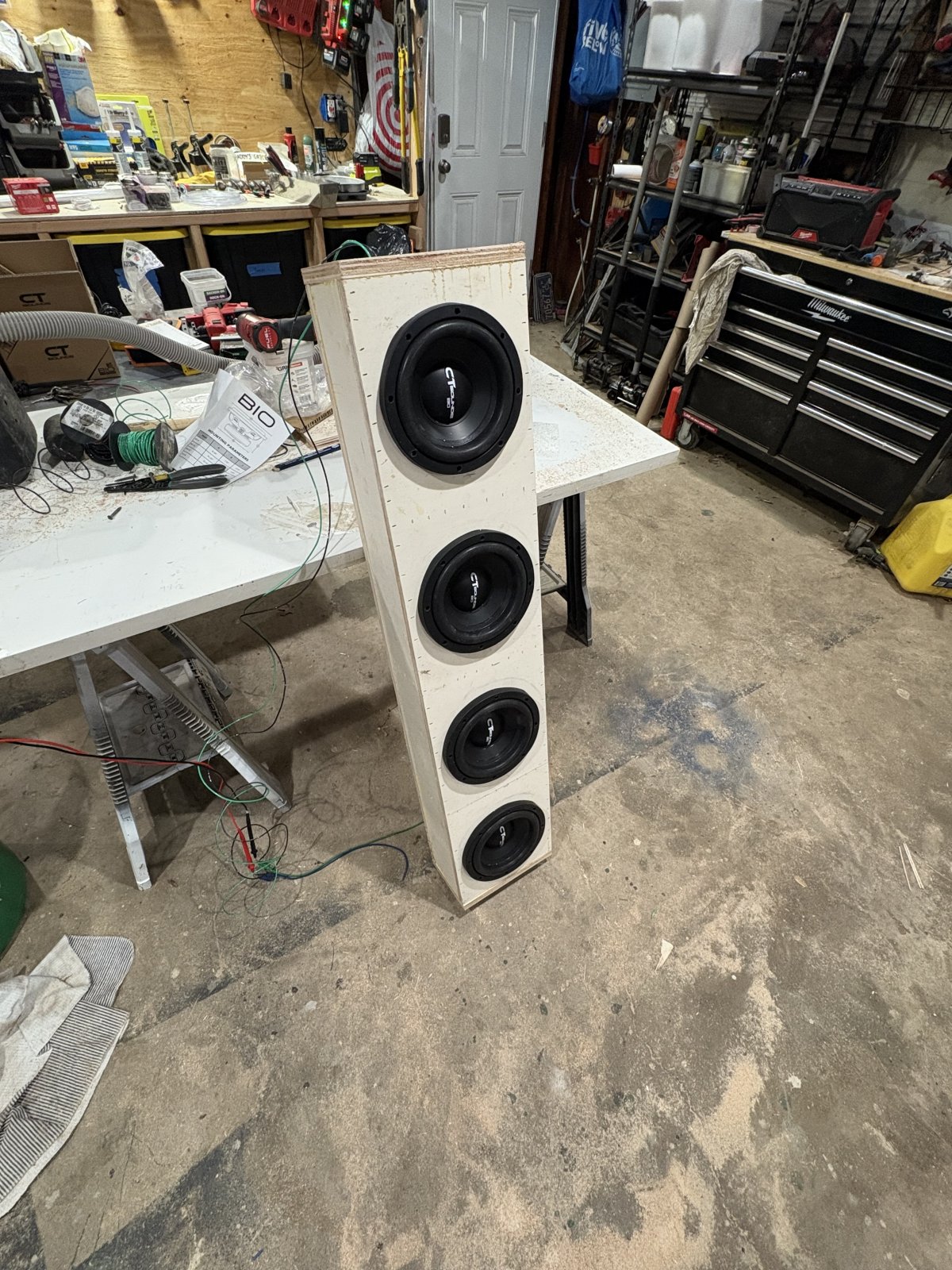

Right now I actually have 4 8” subs in a sealed box in my van. They only call for .25 cu ft per sub. I have the smallest box behind my seats and they definitely have a nice tight thump to them.
However it all boils down to me taking a tape measure to the back center space and figuring it out. I already have a 12” sub that is collecting dust, so I’d like to utilize that if possible

Right now I actually have 4 8” subs in a sealed box in my van. They only call for .25 cu ft per sub. I have the smallest box behind my seats and they definitely have a nice tight thump to them. View attachment 459610
