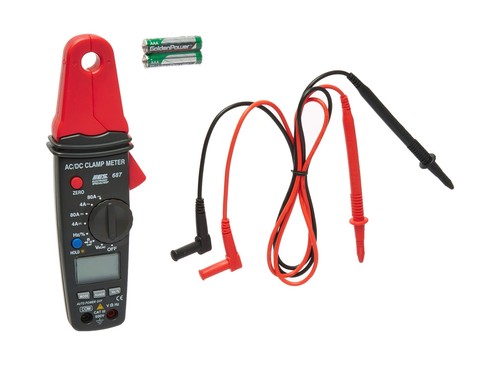

The Amprobe LH41A Low Current Clamp-On Ammeter enables one to read direct current flow without breaking the circuit. This is the only clamp-on DC ammeter that I have found. All other clamp-ons are for AC and if they say DC, require you to open the circuit and use leads. This meter will show any DC current flow, even very small currents.
This is the more affordable one I have, and it reads DC mAH values with the clamp. I used it on my parasitic draw problem.
