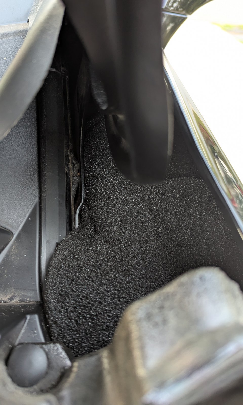

Having problems uploading pictures (I'm guessing they are too large, had to crop these ones down). Hopefully these make sense.
We'll see how well it works, but I only spent like $30 and it's certainly worth a try. I wracked my brain trying to figure out how to fill the void with gutter foam but realized that I didn't need the whole thing packed full, I just needed it to block the top. It should be easy enough to see if it's working as intended and just as easy to pull out and clean. Much better than wet leaves and dirt accumulating in the bottom of the fender and rotting it out over time.

Update: Yes. It works fantastically. Instead of the leaves collecting at the bottom of the fender, they are right there at the top and takes 3 seconds to scoop them out. Might be stupid, but I'm happy with it. I've seen a lot of 80s 90s 00s gm vehicles rot out at that very spot, hopefully this will help minimize that from happening here.

Derek Bieri says “ is it really a dumb idea if it works”? Go get ‘em brother. You’re right that many vehicles have gone to the scrap yard bc of rot there.
