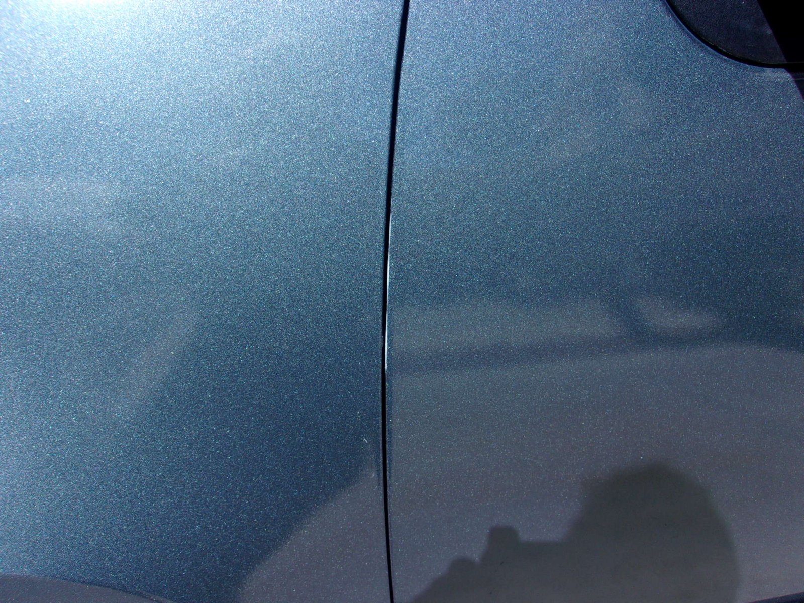

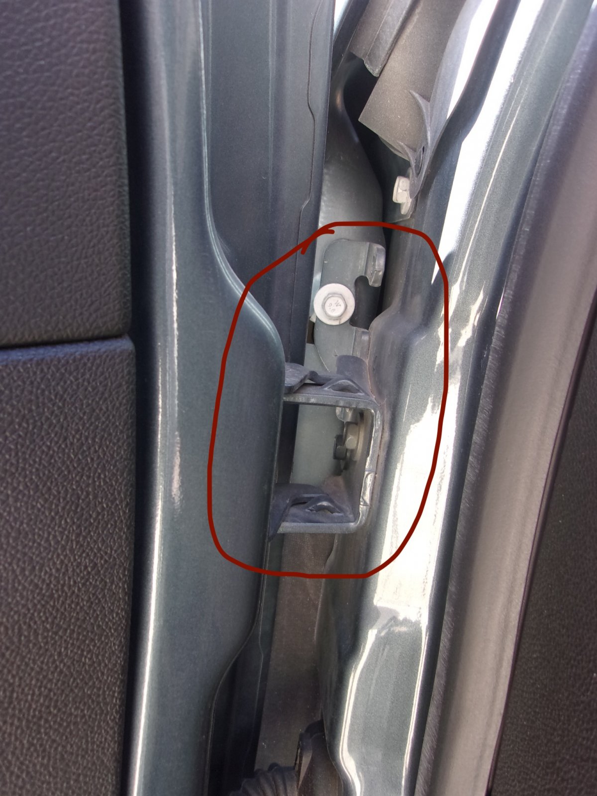

Hey, guys,
Just this afternoon, the driver door started bumping against the fender on opening. Nothing crazy happened prior to this that I am aware of. I can see that the gap is very small, and paint has been rubbed away. On the inside, I see nothing indicating a shift in the hinges, etc. It's a loud pop on opening, nothing on closing. Is there anything I can do before throwing money at a body shop to see what they say? Thanks for the help in advance. Jim

In your case, I'd recommend taking it to a body shop and ask them what can be done to resolve your issue. To my knowledge, the door hinges are not adjustable for alignment purposes, but I've never looked real closely at them.

Have you had any mechanical work done to vehicle recently?
No, no work done. Thinking back, I know it was very windy (35-40mph) the day I first heard the popping. Maybe a gust of wind caught it when door was opened. I could see that the edge of the door at the top/back was very slightly further out than the body area it closed against. I placed a small 2x4 at the bottom back edge, and closed the door so it was against the body metal at the bottom. I pushed the top of the door in (closer to closing) several times, and it stopped the popping on the fender. I removed the 2x4, and closed the door. It now is even where it meets the body. No more popping.

Probably going to have to replace the hinges. Sounds like one or both got bent in the wind /2x 4 incident. Hard to tell which one. Unless you’re saying you fixed it with the 2 x 4 in which case lucky you.

Just to wrap this up and put a bow on it...The popping returned, slightly. So, I loosened one of the two bolts on the top hinge, on the door side, slipped a small washer in between the door and the top hinge, and tightened the bolt just a bit. Then, I removed the bottom bolt of the top hinge on the door side, and did the same. Then, I tightened them both down all the way. The result was about a 1/16" larger gap between the fender and the door. It looks fine, and works with no pop, and no change to the closing of the door. All joints are in alignment, with no noticeable change to the gap, top to bottom. I think it is fixed this time...
