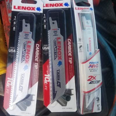

I did something similar. I used a 4.5" grinder with a cut off wheel to cut the outer skin then I used a Sawzall with one of those bad ass carbide tip blades to cut through the inner skin. It worked great and was fast. Pictured on the left.
But, when I got close to the tank I said "just a little bit closer" and boom. Thankfully I only nicked it. The tanks are thicker than you think haha.

Yup. Same thing I did except I stopped soon enough with the Sawzall then went back to carving with the cut-off wheel.
