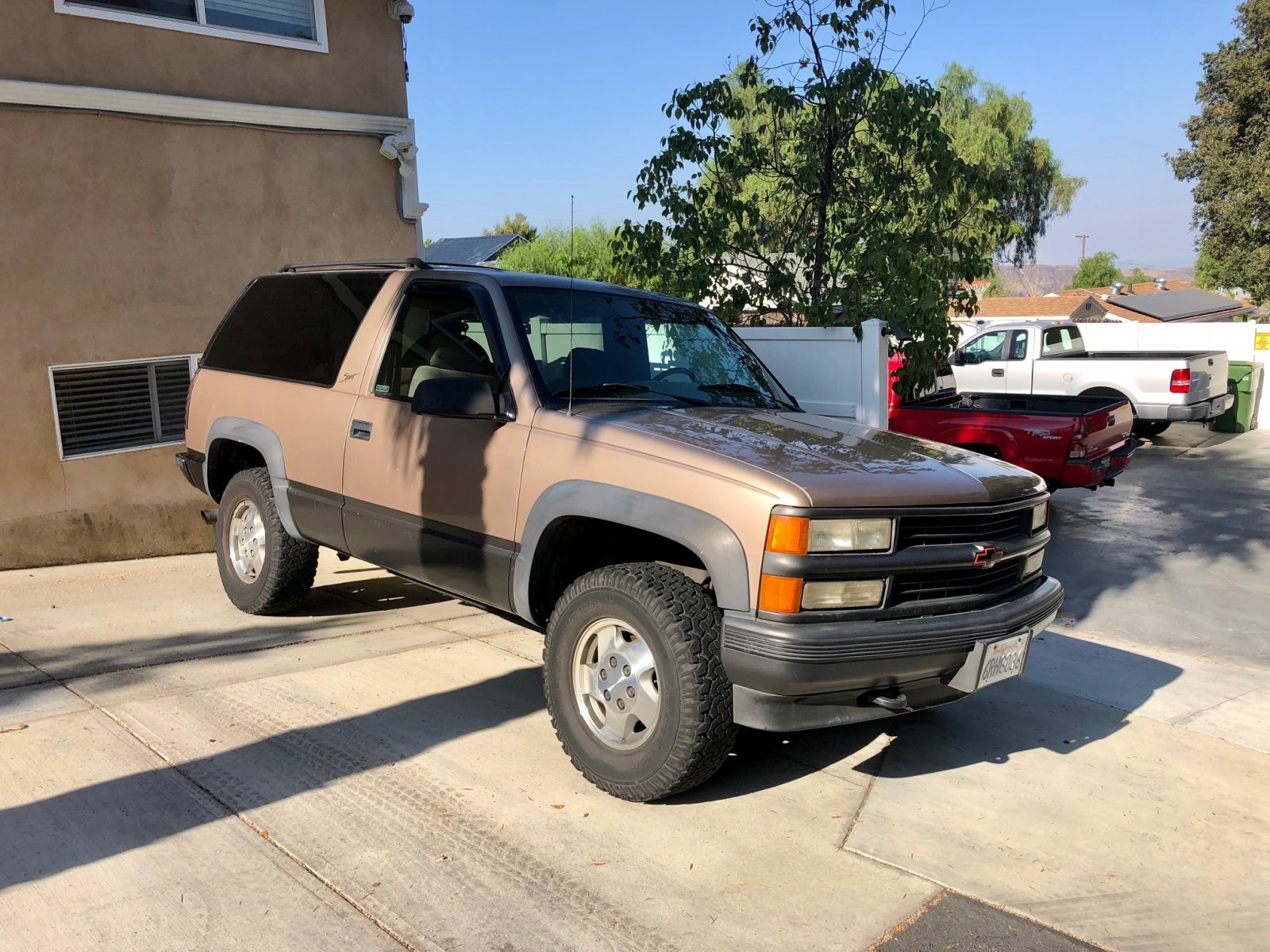

Nice clean looking truck. Low miles?
It's unusual for car thieves to disable a vehicle they are trying to steal. Hope everything works out and you have better luck.

Ya fairly low miles...220k. It was my full time rig until I got into the pool cleaning business...then my work truck became full time. Since then this has been my weekend fun rig. Early in my marriage my wife tried getting me to sell it...but no way in hell.
This whole thing is telling me now that I need to add some security. All it takes is one lowlife thief take it away.
