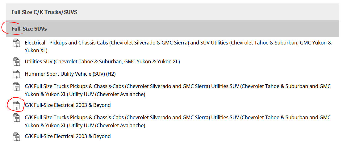

What year?
If 2003 or so, grab the upfitters guide here: https://www.gmupfitter.com/light-duty-vehicles/light-duty-prior-to-2013/
Click on Full-Size SUVs, then download the C/K Full-Size Electrical 2003...
Search for the LEFT BEC fuse center info, which is one of the places that @Doubeleive recommended. The available circuits there are detailed.
