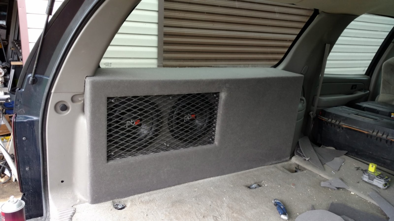

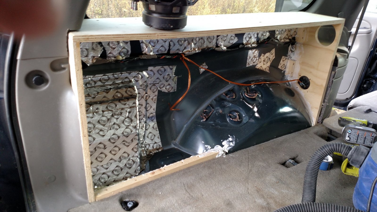

Have gotten rid of the Powerbass subs, and have stepped up to a pair of American Bass XR10's, being pushed by a Soundqubed S1-2250 @ 1 ohm. Also have a single XR10 that will be in the rebuild of my center console, pushed by a S1-1250, also at 1 ohm. During the rebuild, am fabricating an amp rack under the center console, housing the 2250, the 1250, and an S4-100, which will push the door components.
Specs on this enclosure are roughly 2.6 cu ft net, tuned to 28hz, with a 4" port 11" long. I really should have a bigger port to achieve more output, but it would end up being too big, and the enclosure would be closer to 2.0-2.2 cu ft. The center console sub will be tuned the same, with 1.3 net cubes, also tuned to 28hz, but with a 3" port.

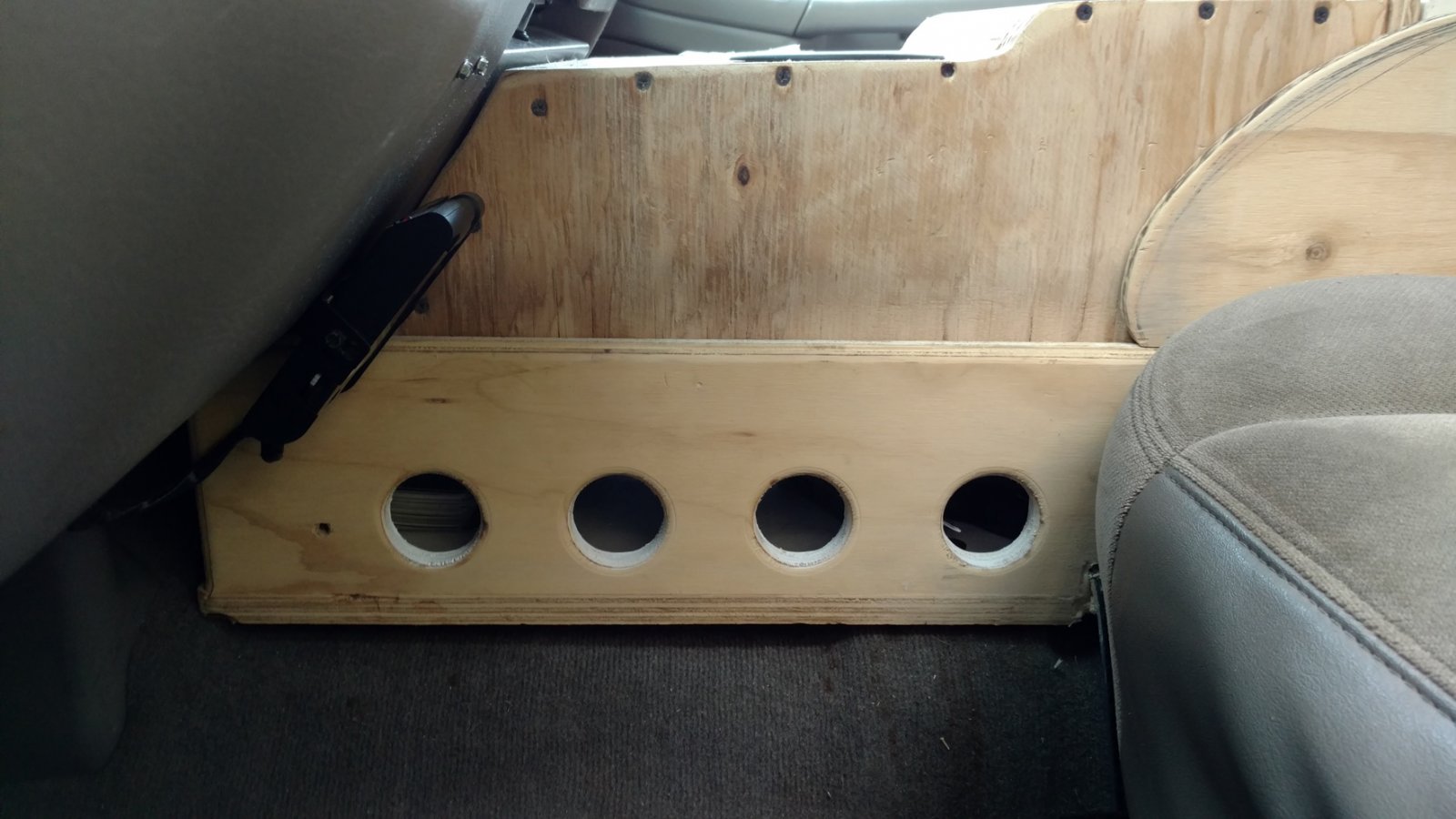

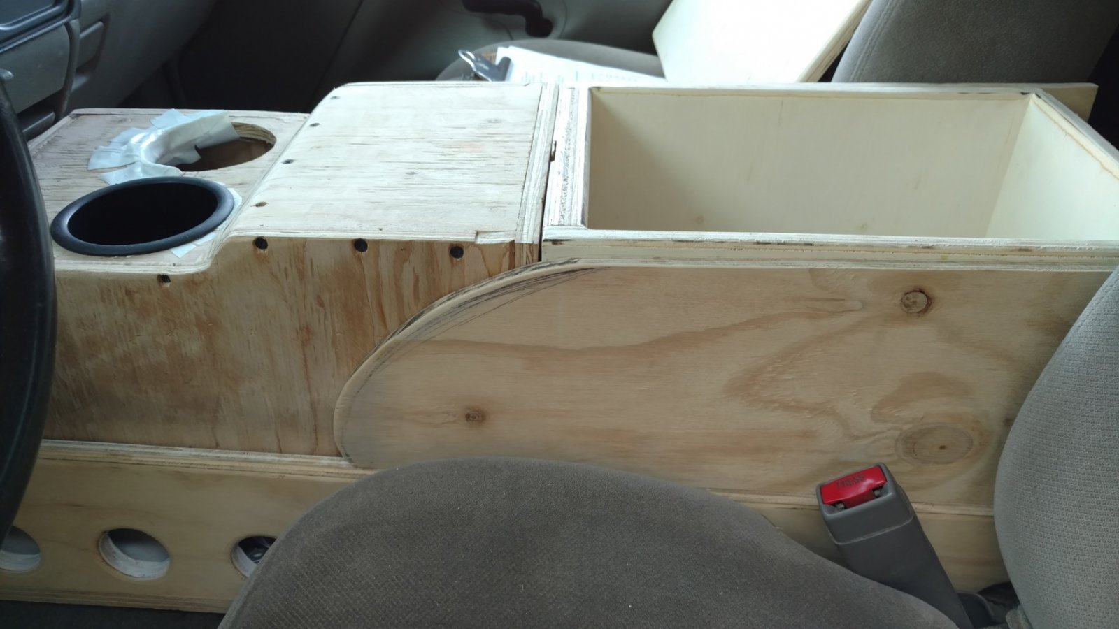

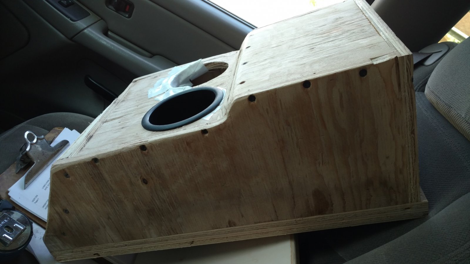

This is the basic idea of what I'm redoing. With this console, the forward section is a sealed enclosure that I had two old Kenwood 10's sealed as lower midbass, running off a Lightning Audio 1K (but only a legit 250 watts). Not going to change much as far as the general shape, just going to reconfigure it so that the single XR10 will be forward under the cupholders, firing downward. I may make the baffle for the cupholders (actually 4" ports, sealed on the bottom) out of Lexan and have a removable trim panel - that way I can show off the beautiful backside of the magnet and basket. Plan on stacking the three amps in the rear of the console, with all the adjustments to the rear - I'll be able to pop a trim panel off and access the crossovers and gain adjustments.Should leave me with a storage area about 2 1/2" deep under the armrest.
