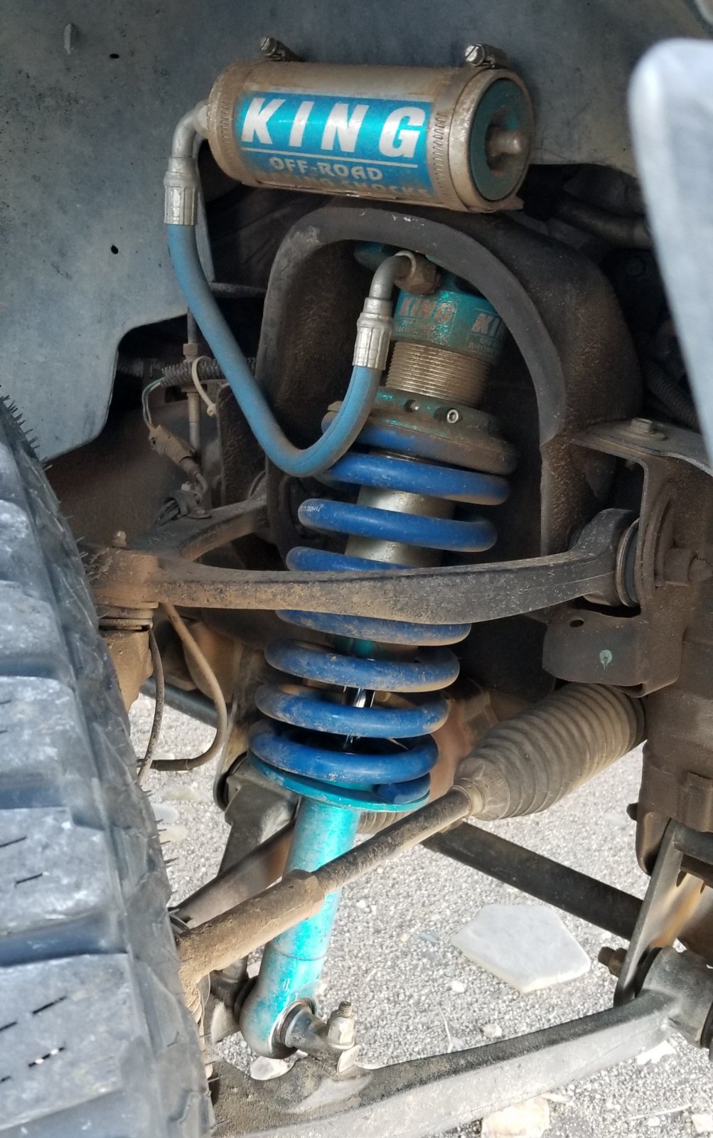

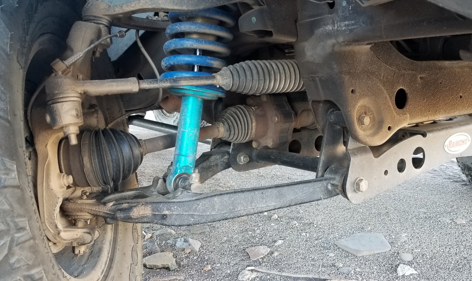

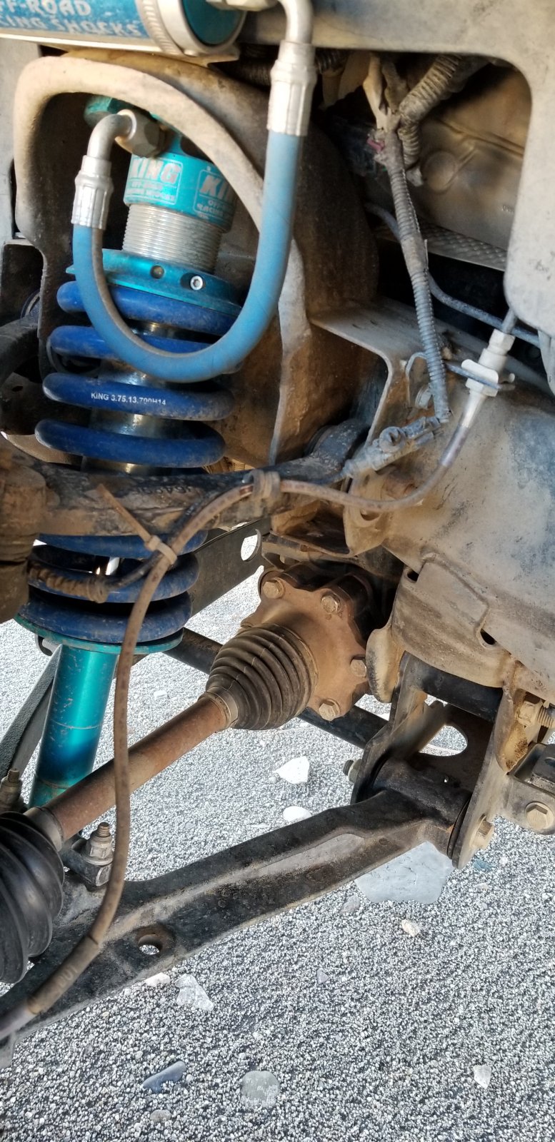

Here are some photos of my front end. As noted above Rancho 4 inch lift with custom built King struts. The strut is much longer than stock with longer travel too. I don't remember the spring rate but, it was chosen to match my vehicle weight in the front.
The Rancho lift changes were, control arm brackets, diff lowering brackets, steering knuckle, sway-bar relocation brackets, drive spacers, steering ends and stainless brake lines it originally came with a Rancho strut.
