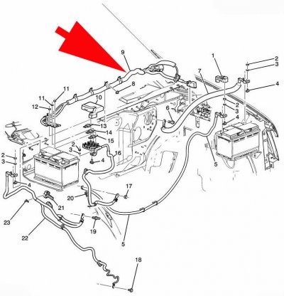

Added a parts diagram, if I remember right 1 goes to alternator 1 goes to fuse block 1 goes to the dash.

it's a PPV so that means it would have extra accessory equipment, i.e. police radio, computer, light bar, etc.
all that extra equipment requires extra wiring to the battery, hence it has a several higher gauge wire hookups which have a integrated fuse.
that is perfectly normal and depending on the year and type of extra equipment that was on the vehicle the battery fuse panel may look different, some may have less wires.
so no it is not some mysterious switch pod, no hydraulics or anything weird like that. just extra power connections plain and simple

I think there's usually a cover over that, snaps off for access.

That is just a power distribution center. Look at any newer GM HD truck and you will see something similar to that. It's a nice thing to have if you plan on powering other things, or tying in a second battery.
