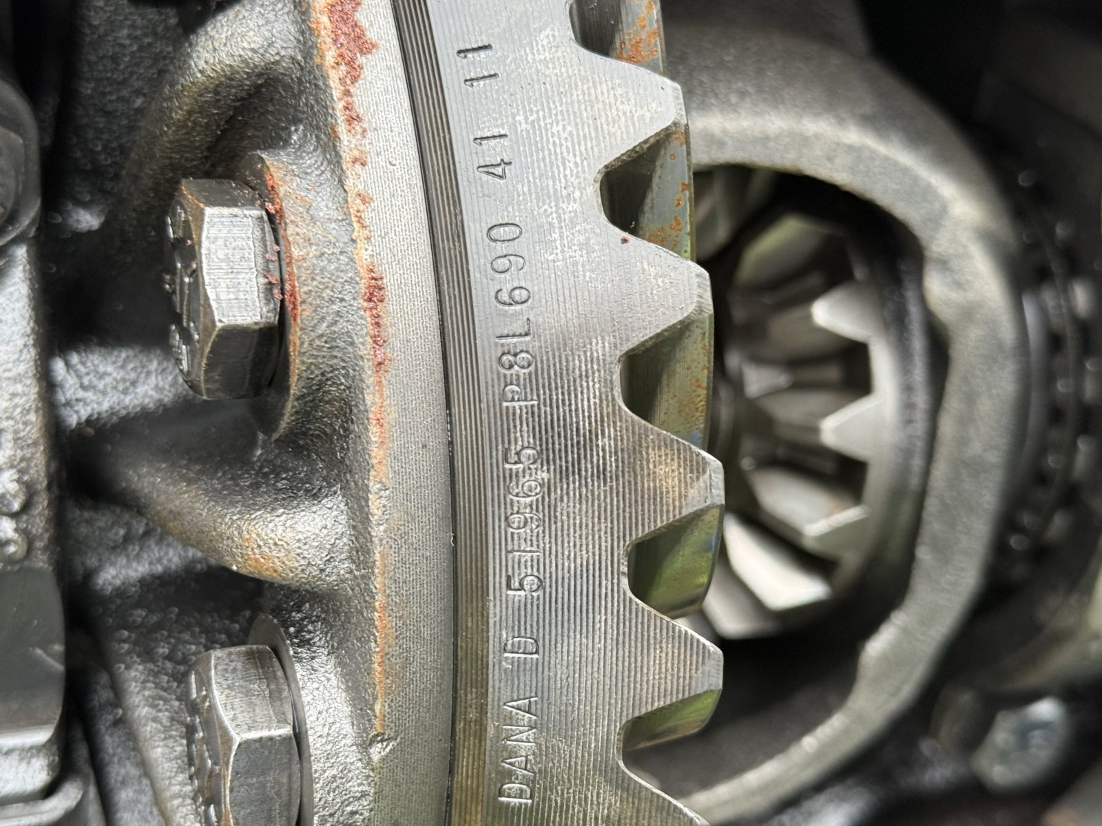

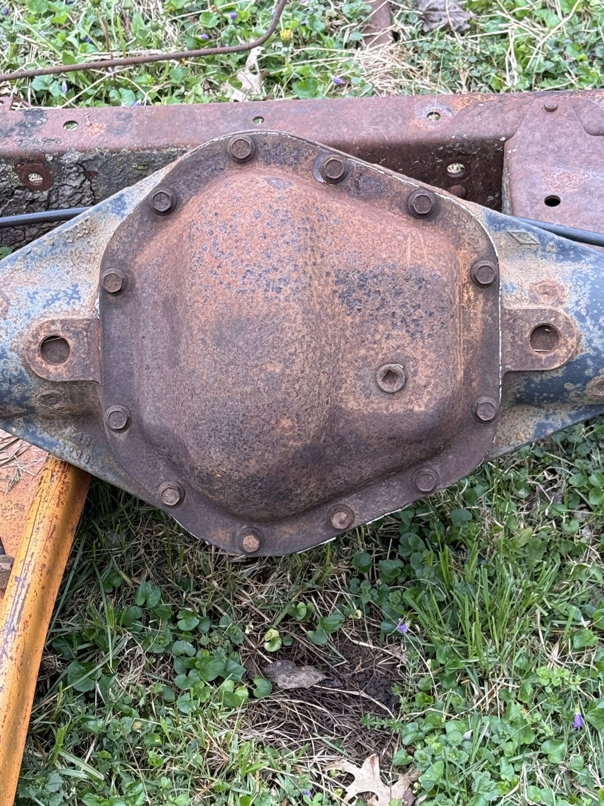

I know it’s a Dana and it came out of an 04 GMC Van, but I can find any information to build it for my son’s truck. Can anybody help?

I was thinking it was a 60, but the cover has the 12 bolts and the other 60’s I have found all had 10 bolt covers. I did find that the old truck 12 bolts had a true 12 bolt cover. However with this rearend coming out of an 04 van and having 6 lug axles I wanted to ask others. I have searched every number on the rearend. I also called the Chevy dealership and searched on DANA’s website and got nothing.

It's a Dana Super 60 for GM. 9.75" ring gear right? Dana Super

I agree with you but we are cutting the spring pitches and relocating them. The truck it is going under is a street/strip build and this is the must economical route to put a bulletproof rearend under the truck. That is why I am asking about it. Everything in/on the rearend except for the brakes is Dana, but it’s gonna need a posi.

Yeah, I believe the Express vans ran the Dana 60S (60 Super), but I thought those were all 2500/3500 series with 8 lugs.
Sounds like you are converting it to 6 lug, right? Do they sell lockers/LSD for the Dana 60S? Or is that not needed in your application?
Another option for a swap is to use the old 14 bolt 9.5" SF GMT800 8 lug (not the 10.5 full float) and swap axles. There's some modifications using Express Van 6 lug brake calipers also required. I've read this on the performance truck.net. They have a sticky on this swap
