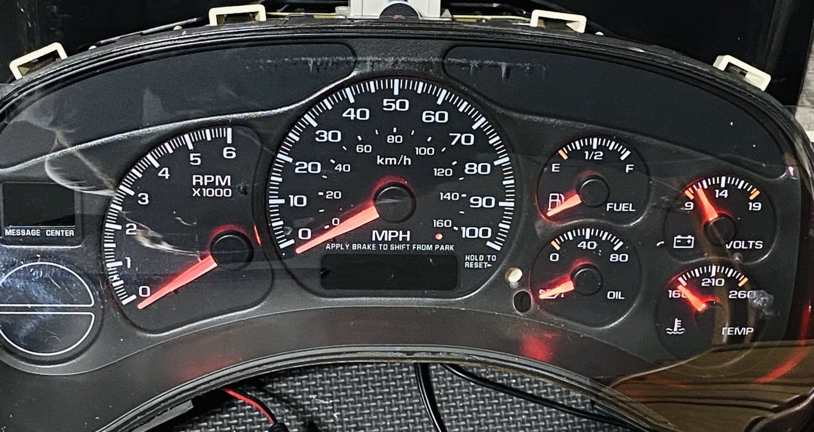

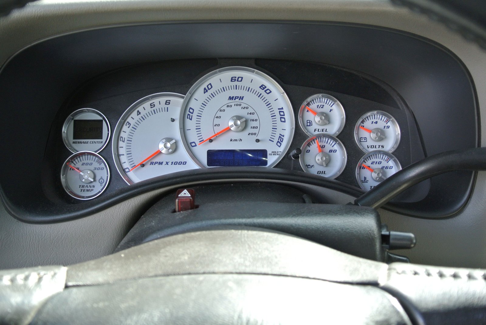

I modded my '05 gauge cluster

I initially had one done in blue/blue with a white background which looked nice in the daytime but at night the gauges were washed out, so I had it changed to red indicators

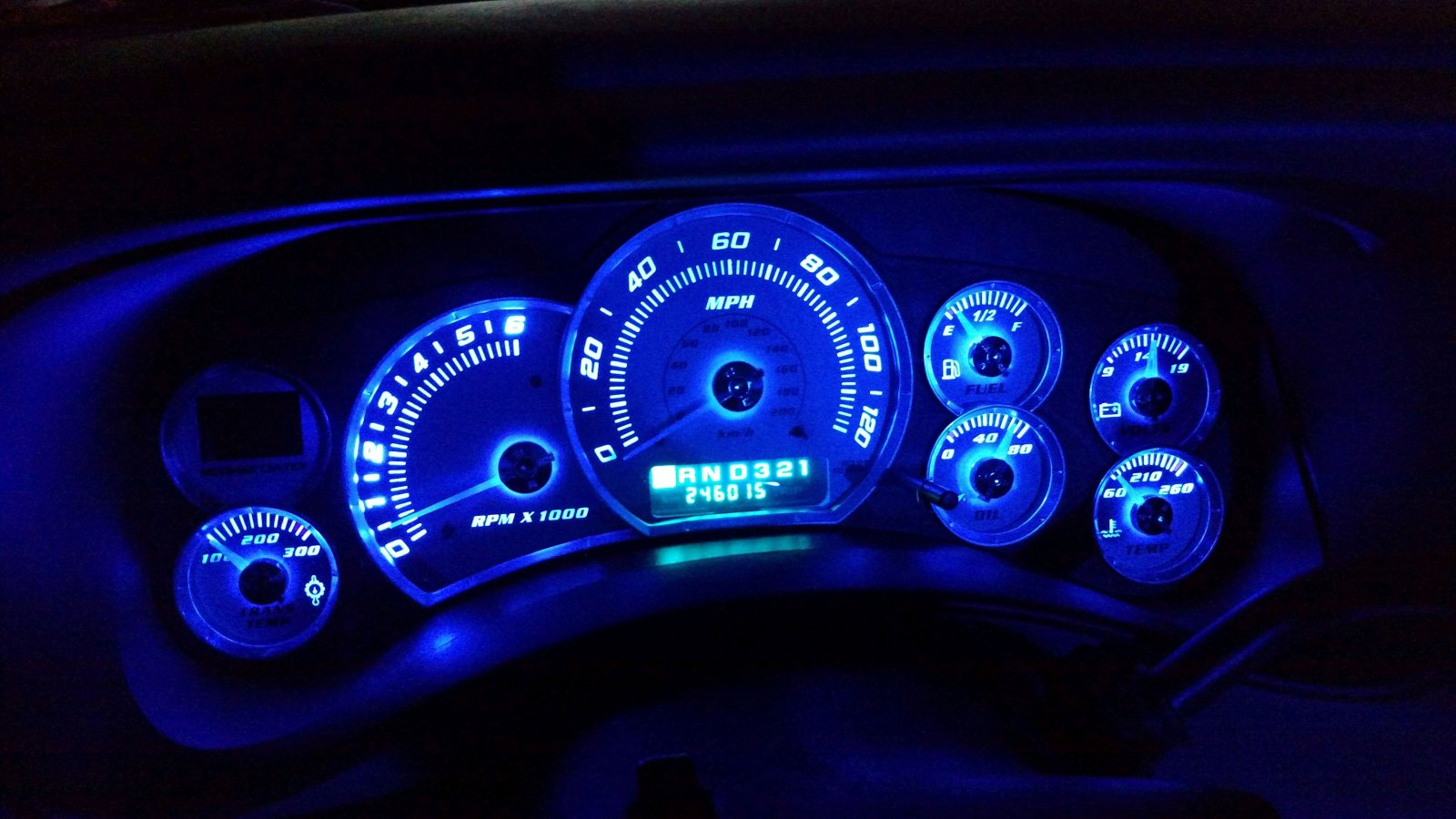

Looks nice bud. Good work. I have two '02 clusters as well. 1 from my '02 Tahoe and also an Escalade cluster I ordered so I could have trans temp. I'll try and get some more pics later today. I modded it too. I used to be on this site a while back before my Tahoe was smashed in an accident. My screen name was MagicianElectrician

Shaded. Do you mean the white translucent paint or the turquoise colored paint?

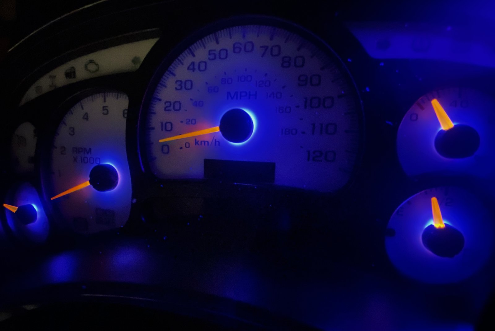

when you hold up the oem backgrounds to a light, parts of it are shaded, on aftermarket backgrounds they are typically not shaded this causes light to bleed thru and create hot spots. He said he has asked some of the popular cluster background makers that sell them online to do it but has never got a response

Ah yes. I gotcha. Im not a big fan of it personally. You can buy diffusing film/paper really cheap. Just cut to fit right under the overlay. 2 layers if you want. LEDs by nature are very directional/focused lights compared to an incandescent bulb, which is about the equivalent of a tiny fire burning, so although very hot compared to LED, the light goes in every direction. And our clusters were designed with incandescent bulbs. '03 was a little better by adding more to help even out the light better, but still by far a bare minimum amount of light in my opinion. And that's because if they had added more, heat woulda made short lives of our clusters. If only GM had foreseen the fact that LEDs are abundant nowadays and being used everywhere.

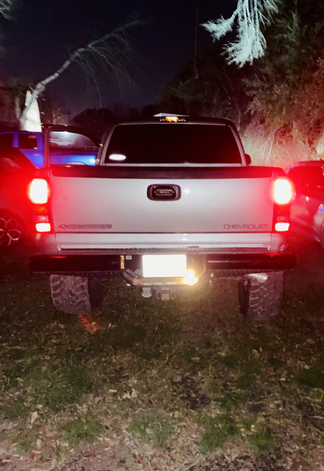

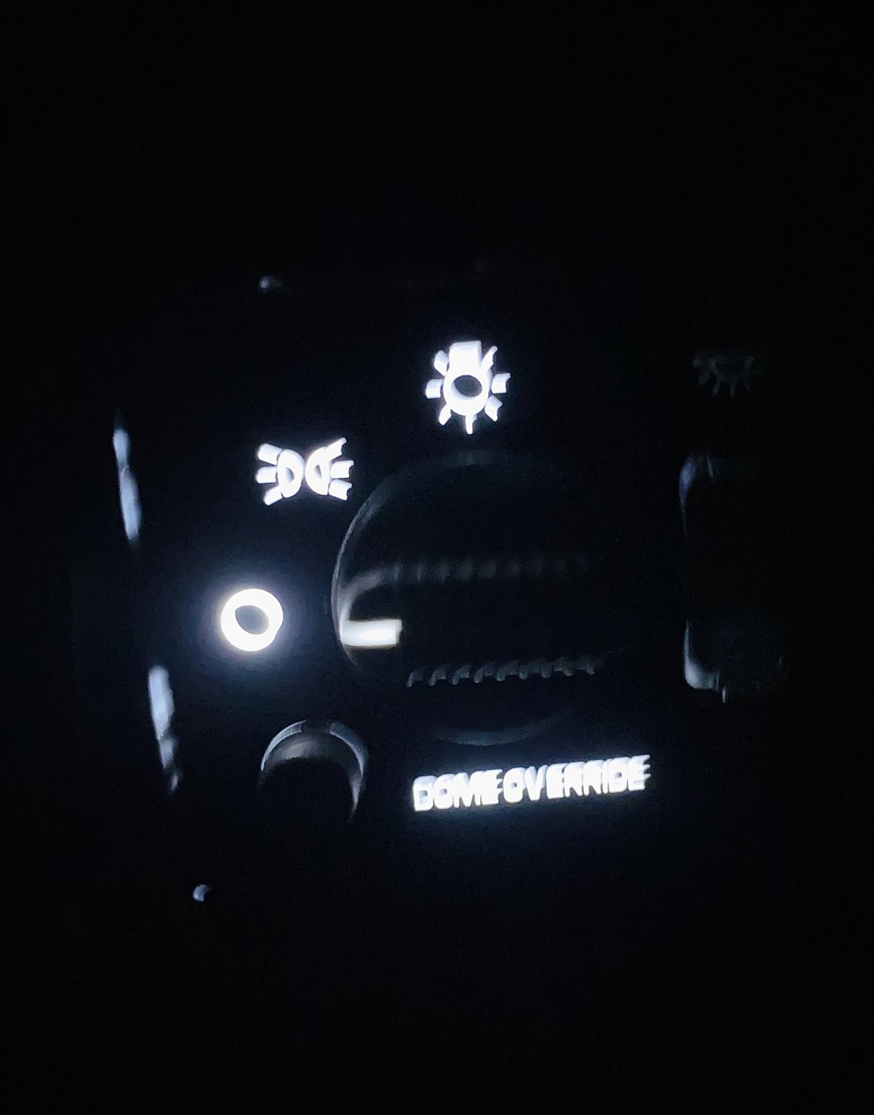

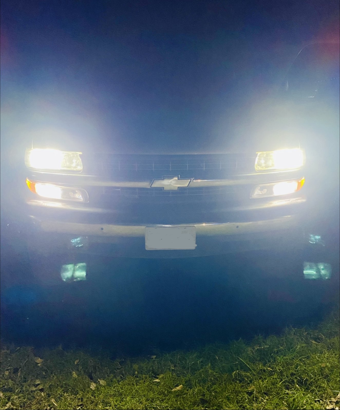

I finished turning everything to LED on my buddy's '99 Z71. Inside & out. Even all the interior buttons. Did the cluster too. He wanted to still use his stock needles, but wanted em to glow red. So I took the orange paint off, made em white, and gave him LEDs for each one. They can be any color really, just set for red for him. Headlights are 60,000 lumen Sealight LEDs. INSANE difference from stock halogens. Cost just over $200 for everything, including a new cargo/break light and new door panel step lights.

What did you do to get rid of the greenish tint for the AC/Light control switches? I've swapped to white LEDs and the green tint is still there. Did you just remove it from the inside of the switch?
