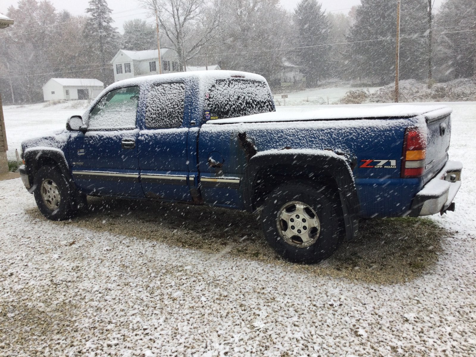

Tonyv, Thank you for the advice. While the bed removal procedure would have worked swell for my ‘02 some years ago, it’s actually rusted so badly that I’d be concerned that the bed may not come off in one piece. In fact, it’s so eaten away, that I’ve even considered just cutting a hole through the bed to gain access to the fuel pump :) My goal is to get this truck through one more NE Ohio winter and possibly into some of the summer months. I’ve got about 355,000 miles on it and had it since new. And today is the 1st day of snow, of course. And the salt trucks have already been out……

Thanks for your input. I considered the crank sensor, but then again, the truck starts right up every time and idles smooth. It runs perfectly up until 2,000 rpm or so, and then cuts out, surges and pops through the intake when the accelerator is depressed. My understanding is that the crank sensor would cause hard starts and poor idle. Who knows, it may end up being the sensor afterall. However, since discovering the fuel filler neck being rusted off and having driven through a hard rain with rust-perforated wheel wells when all of this began, I’m going to try and rule out water and rust infiltration within the fuel pump 1st. In fact, I’d be pulling the tank today, but I’ve got one of those doggone colds where I don’t even want to get off of the couch :-( Hopefully this week I’ll get the tank opened up and will find out if the fuel pump has been affected/plugged.

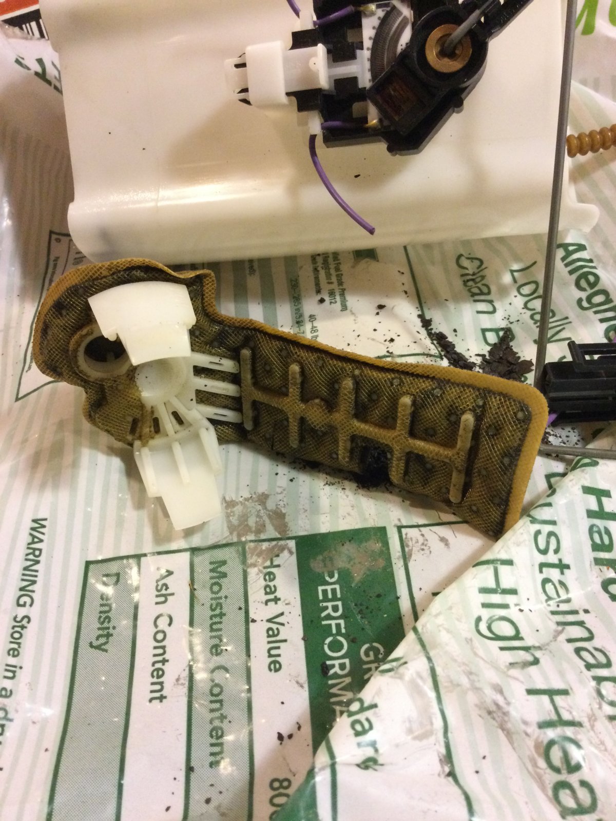

I took the fuel pump housing apart this morning, only to find a pile of rust and a disturbing looking filter. As crappy as that sounds, heck, this just may in fact be the root cause of the acceleration/fuel pressure drop issue afterall.

That very well could be your problem. Hopefully a new pump assembly takes care of it. Good luck.
