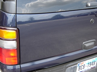

It only had the Tahoe badge and the dealership badge right above it. I just pulled them off. Then it took a long time soaking the adhesive tape with Goof Off and scraping with a plastic paint scraper. Of course you could still see the outline of the badges after that. I just waxed it with Mothers Carnuba Cleaner wax and it removed the outlines. Looks Perfect!

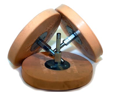

And you should have looked up the 3m eraser wheel. takes 2 minutes tops and the sticky stuff is gone...

Once you get that tool, you will... haha... It will look a lot better with the side molding gone. And it will only take a few minutes with that tool.

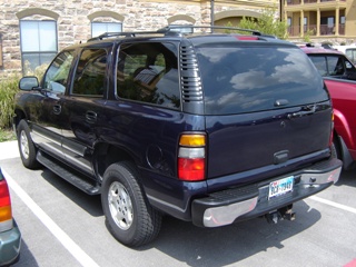

Need Pics or it didn't happen :)QUOTE]
Here. I think it would have taken me as much effort to find one of those wheels and get a drill as it did to scrape it off in the parking lot of my apartment. I just wanted it done right away. Here's some pics.

Looks good. I will look 100% better with the sides off... PROMISE...
