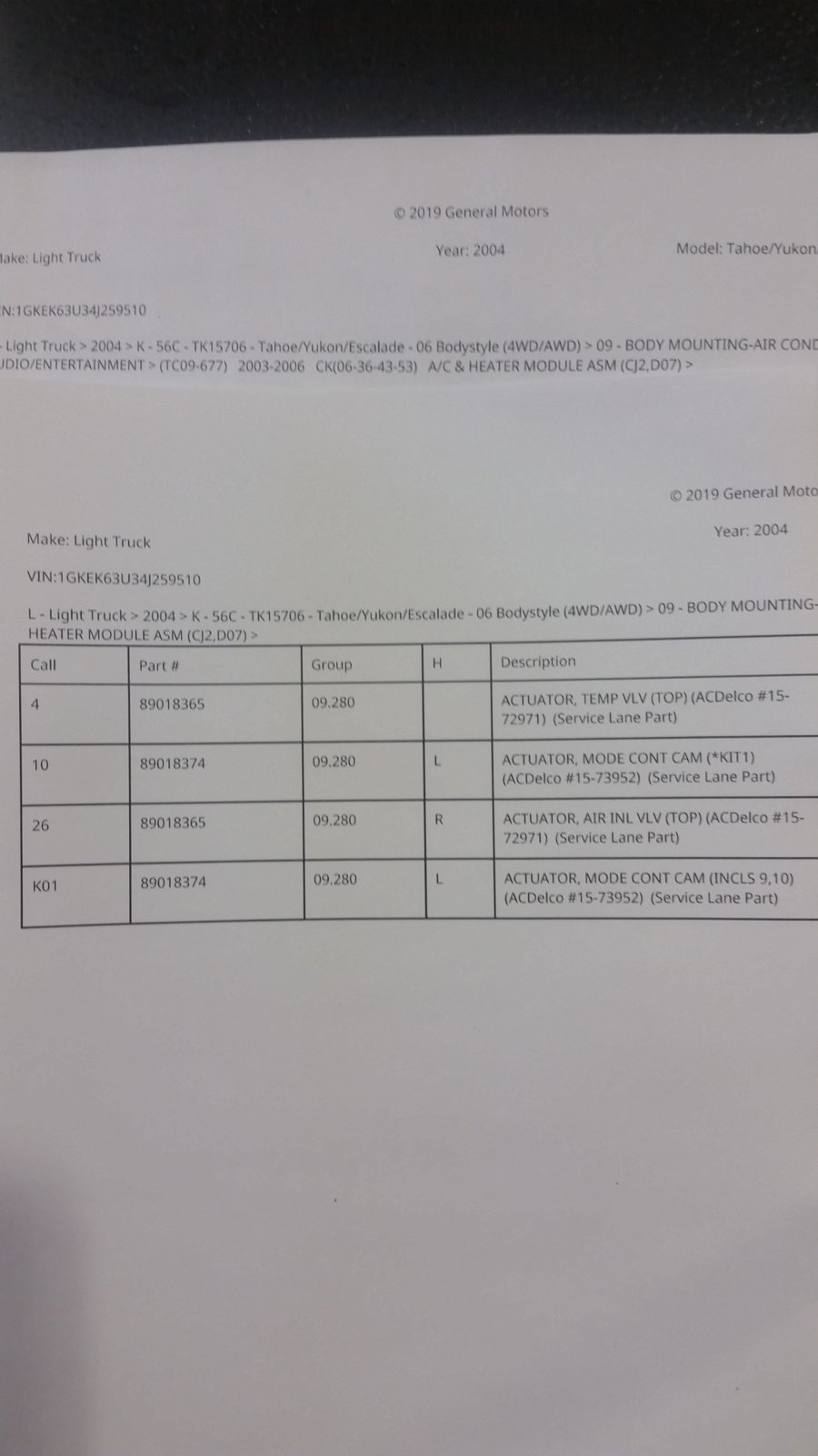

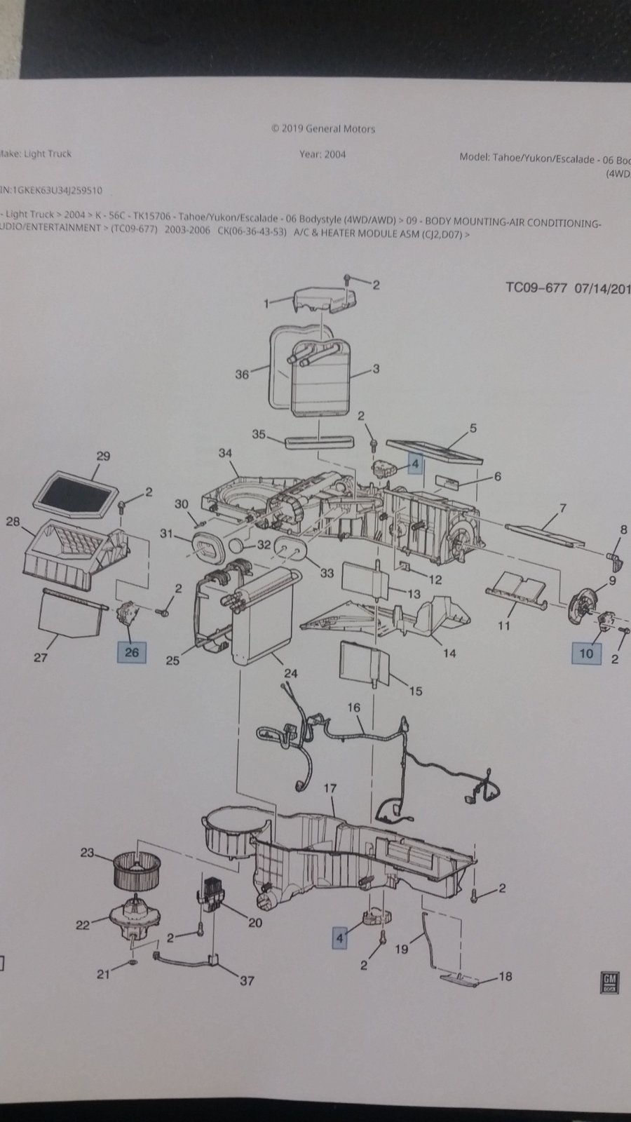

Does anyone have documentation or definitively know the specific location & function of each of the Blend Door Actuators in 2000-vintage Yukon/Sierra/Silverados?

if you give me the last 8 of the vin#, i can get you a break down of the ac unit

Vin is 4J259510

hope this helps
