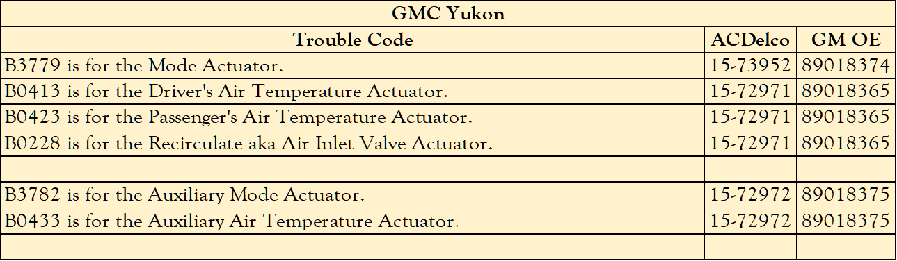

Ive got the following codes and i dont know which blend door(s) to replace. tried looking them up on a gmparts website but there's about 3 different blend door actuators. Can anyone point me in the right direction please?
B0413-04
B0433-04
B3782-04
2009 Yukon Xl. has passenger and rear climate controls if that matters
Thanks
30,704
48,349
based on those codes it sounds like you need to replace both the upper and lower actuators on the airbox
but those codes can be present even if it only screws up a couple times (code+ error count), a visual inspection and test is what I would do.
the main actuator is easy to get to under the glove box, just loosen or remove the lower kick panel requires a (7mm socket)
to access the auxiliary actuator (passenger side-heat/cold) it is on top of the airbox and the passenger airbag needs to be removed.

There are step by step reset/reprogram videos at you tube that you can attempt first. Watch 2 or 3 to see which one gives the best steps and clear information.
