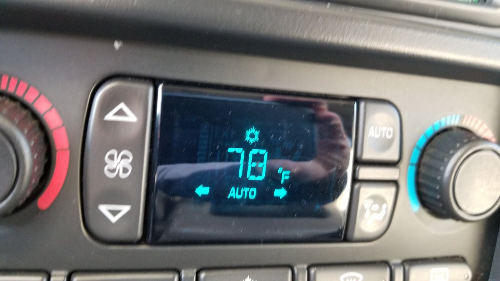

Coming from a 100% manual everything Jeep TJ to my recently purchased 04 Tahoe Z71...
Outside temps below 40F. HVAC on AUTO and set to 78F (I like it on the warm side in winter).
I am still learning the technology and features, so apologies in advance for this potentially stupid question:
Why does the snowflake symbol display on the control?
What is the system actually doing there?
Engine has already warmed up.
I would expect heat, not AC to be running.

Compressor runs and acts as a dehumidifier.

Thanks Fless and Swathdiver! I was worried that something was haywire in the electronics controlling the system...

Auto turns a/c compressor on for dehumidification
But you can 'customize' auto a little bit
You can press the a/c button to disable this feature
You can also override the vent control and let it sort fan speed for you.
And if you press and hold auto - it'll sync driver/passenger temps with the driver's side, so you only have to turn one knob.
