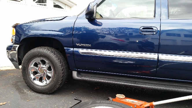

I have some free wheels i got. However they do not sit in the hub, only on the studs. Im looking to get some aluminum rings. What is the hub size for our trucks?

78.1mm
There's no problem with lug-centric if you torque them down properly (in stages, to spec). Also, do you know what the backspacing of the new wheels is? If they're deep and you need spacers, you can get spacers that are hub-centric to kill two birds with one stone.

Thanks for the measurements. There is less backspacing so I don't need to worry about clearance issues. I'm having a hard time measuring the Hub opening in the wheels since I can't get my digital calipers in there. Best I could do is a measuring tape in inches. Left side is starting at 11 in
