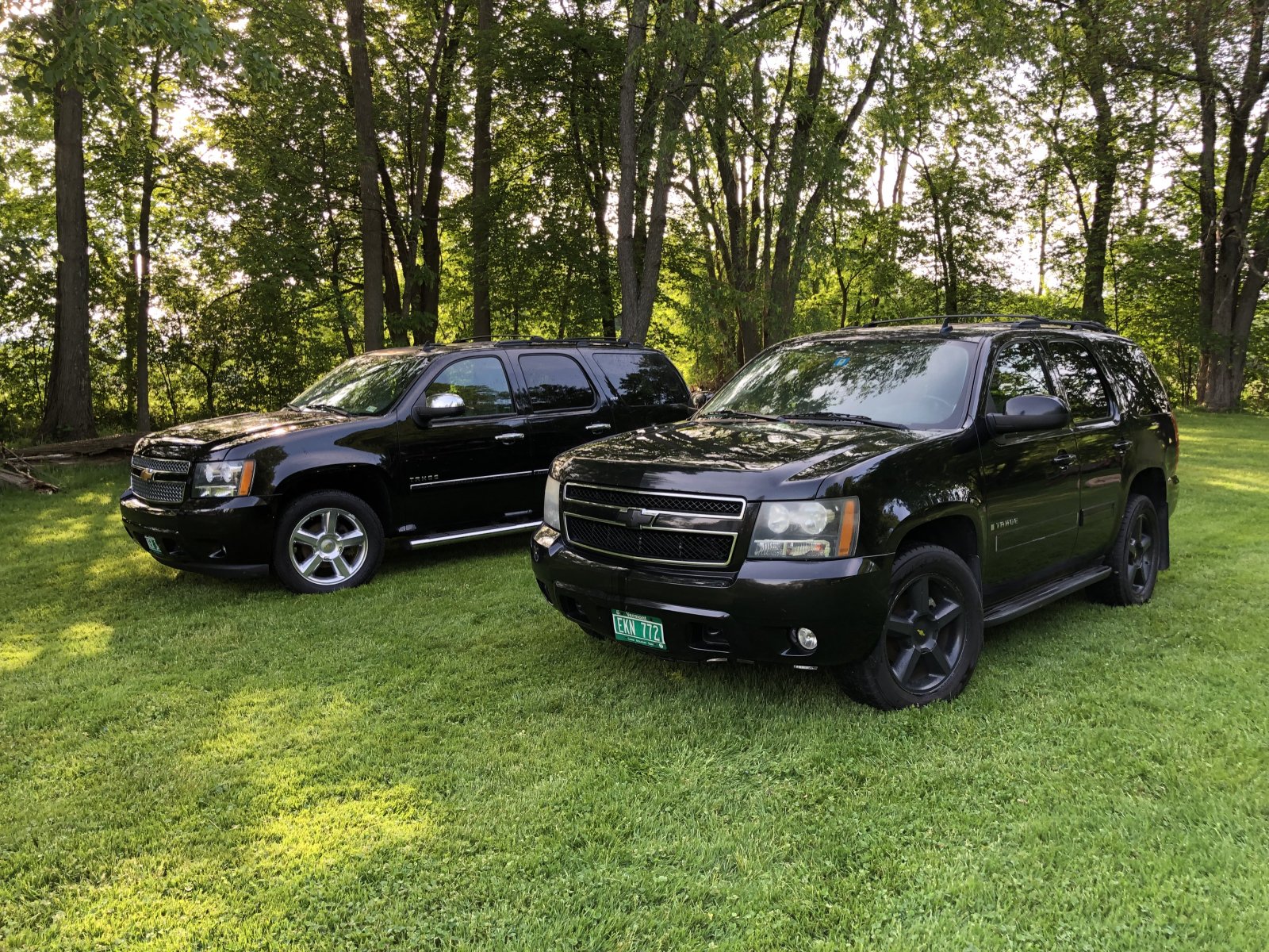

Siblings-2013 on left, 2009 on right.
The 2009 has a stuck lifter. I will be tearing it apart soon.
