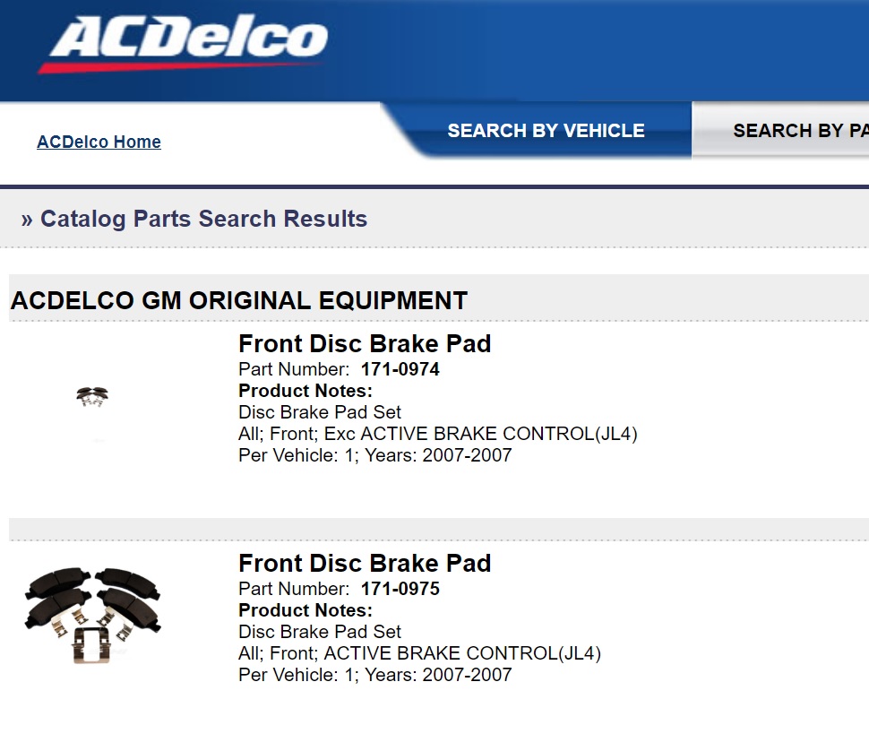

I came across this while looking up brake pads..
Is it safe to say that If you have a traction control switch to turn traction control on and off then you do not have active brake control?
Would this be correct?
I thought you either had Stabilitrak ........OR..........active brake control.
No and no. Nothing to do with the TC button.
There are 2 ways to tell. JL4 in the glove box. 6 flexible brake lines vs. 5. If you have 2 over the rear axle instead of 1, you have JL4.
