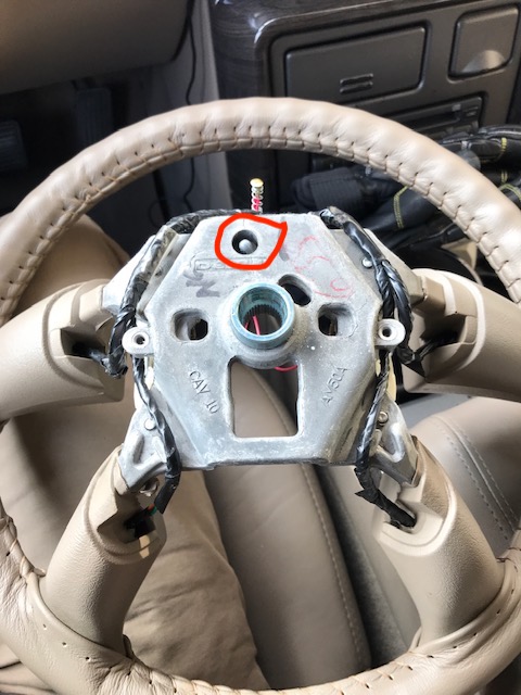

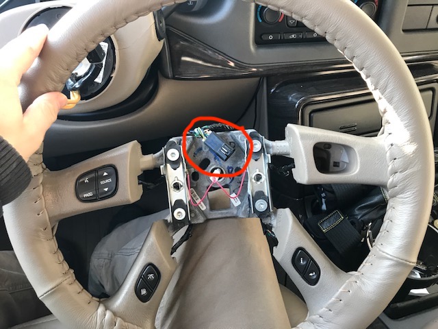

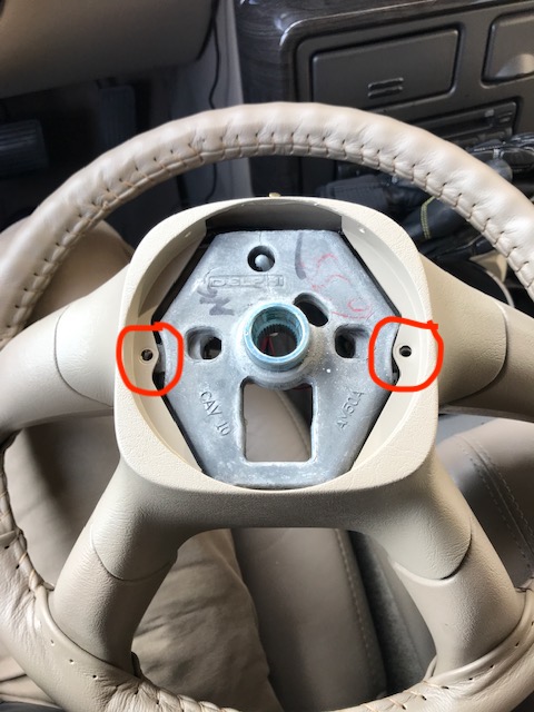

I just thought I would let people know who are weary of changing their buttons that it is soooo much easier if you remove the steering wheel. This way you can get enough slack from the wires. I could not remove my two lower buttons with the steering wheel on and the airbag removed. There just wasn't enough slack no matter how much i tried to manipulate the wires.
Follow these instructions https://www.tahoeyukonforum.com/threads/how-to-remove-and-install-new-steering-wheel.44062/ for removing the airbag and steering wheel. The only difference for me was that I did not need a steering wheel puller. Just a little shake and a good pull and it came right off.
This is the harness you are looking to unmount circled in red below.
Turn the steering wheel over and remove the two T20 torx bits holding the rear cover on.
Use a screw driver or needle nose (if you can fit it) and compress the plastic anchor. Push it through releasing it from the steering wheel. This will give you all the slack you need in order to remove and install the switches.
Put it all back together and your done. Enjoy.
