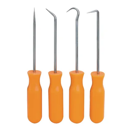

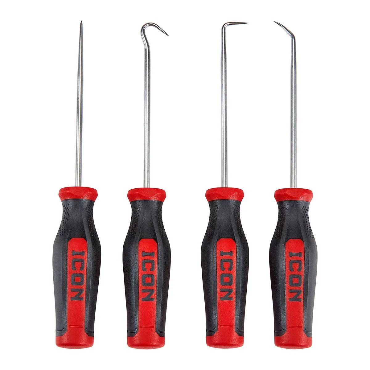

Get the short ones and long ones and the curved end spade ones for picking at seals.

I picked up a few sets of picks at Harbor Freight.
