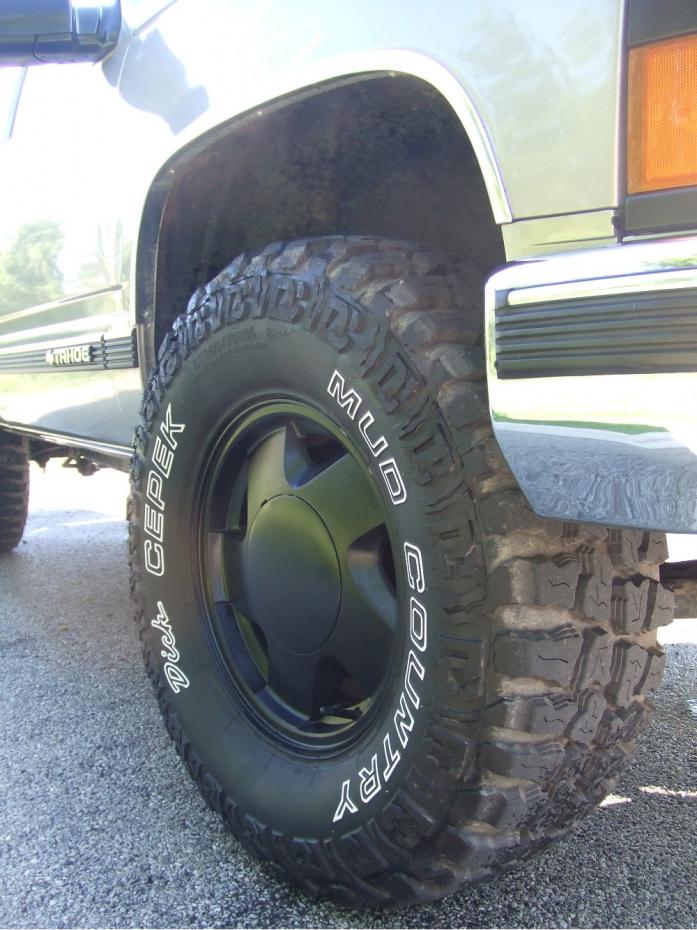

gotta sand the center caps they are aluminum platted, not plastic. and the rims are not steel either. sand everything with 150-200 then go back with a 400-600 wet sand smooth, light prime, paint, clear coat. they will last forever. (make sure you clean well before painting)
