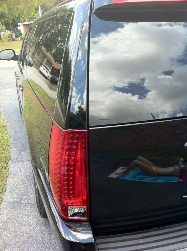

Looks like our wives have the same taste in bikini's, haha. She bought this for Memorial Day...
THE YETI
THE YETI
Director of Operations
Apr 29, 2009
26,963
14,883
South FL
looks like we have the same taste in hot wives... :Handshake:
