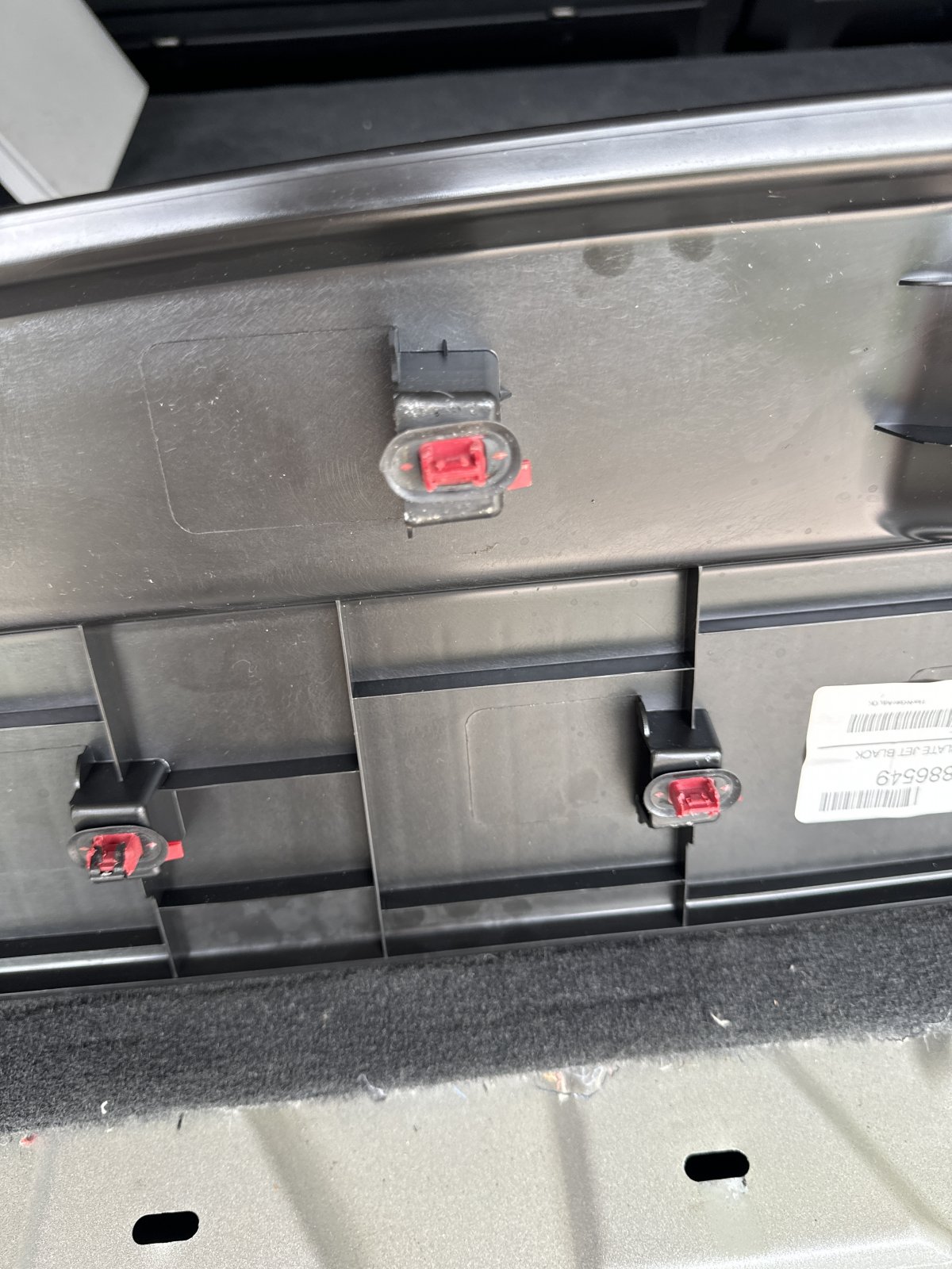

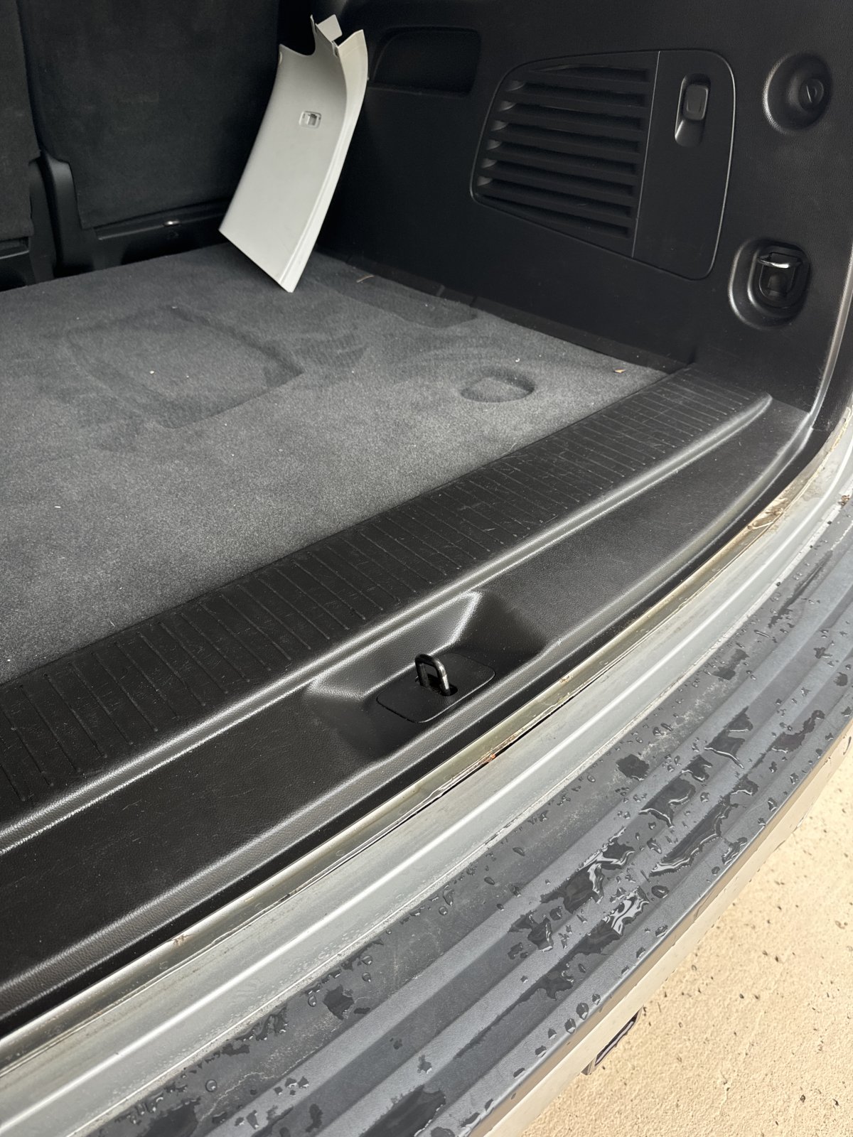

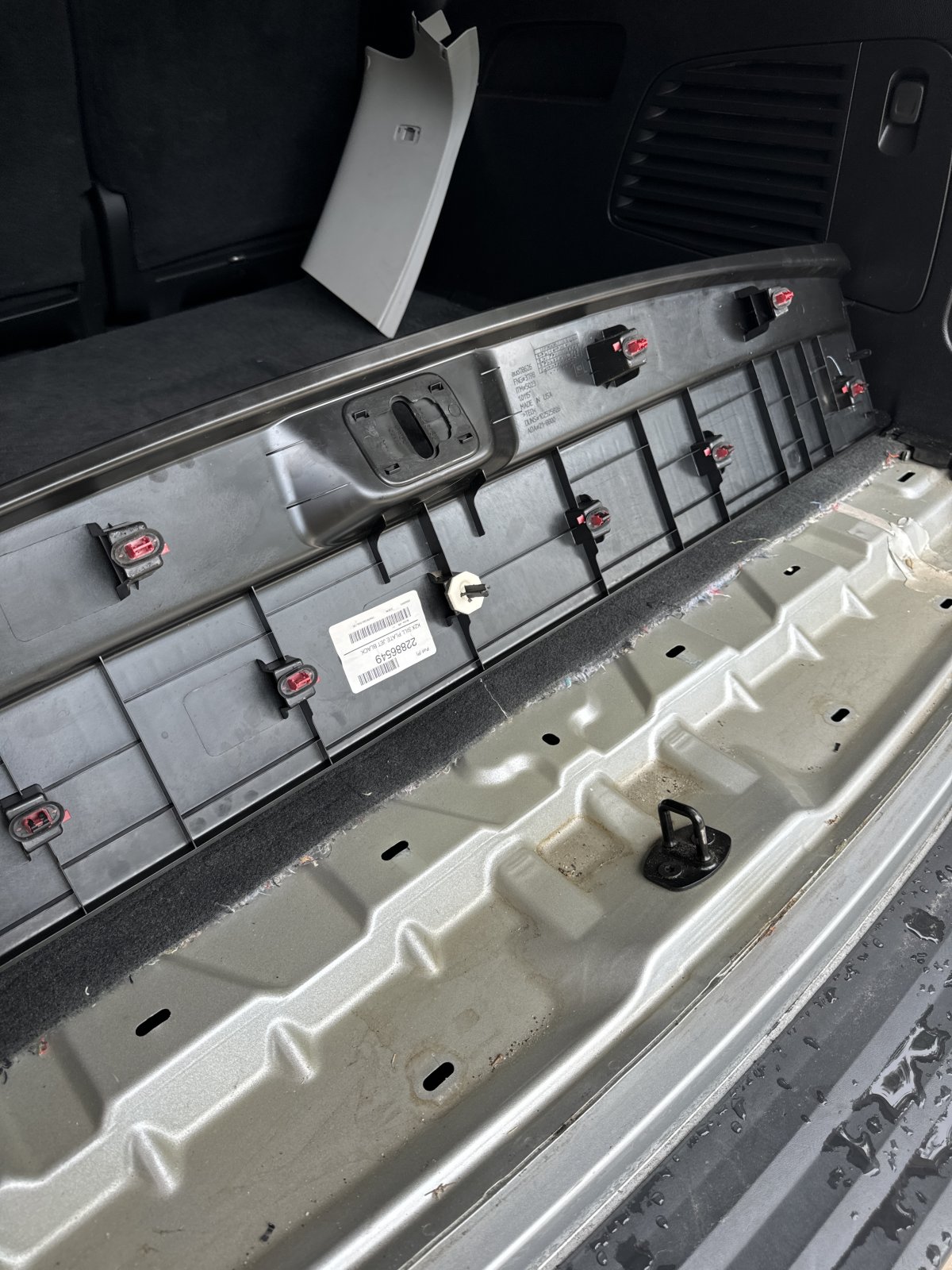

Here are some photos of the clips. I am trying to install a 3rd row seat in the rear.. It’s in a 2019 Tahoe LS. I ended up just pulling fairly hard, probably not the right way to remove, but it worked. Thinking there’s got to be a better way.
I see, no they just clip in, the red top part appears to just be a new way they are put on/replaced at the factory. previous designs vary from a christmas tree design to a more robust plastic clip which is prone to break or held in with a metal jaw that would tear the plastic up.
Appreciate the info! So is pulling these as you normally would for a different clip type still the right move most likely?
ya just pry up and out with a plastic trim tool so you don't damage the plastic, beware of any hidden screws, if it won't come loose take a better look they like to hide them behind plastic covers or inset with other things like coat hooks. If it won't come loose with moderate force then something is holding it.
