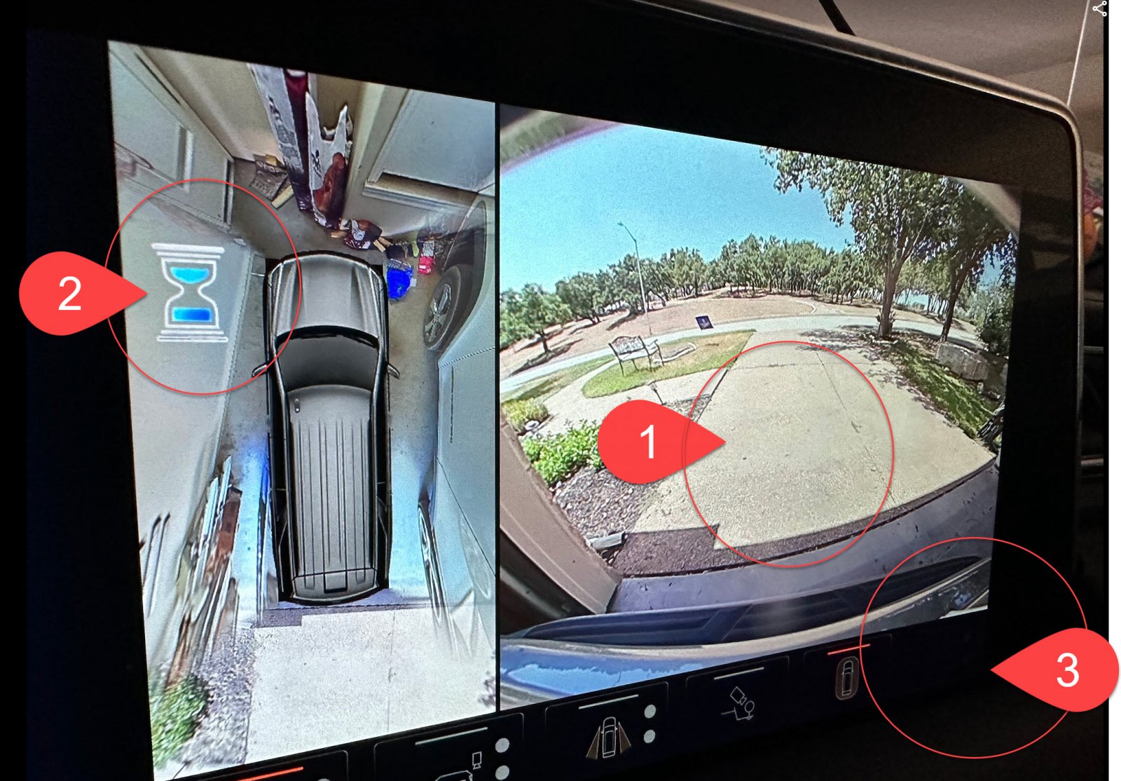

Has anyone experience this? Gridlines are gone and a hourglass is being displayed in all camera views.
Appreciate any pointers to solutions/experience with this.
Picture below for reference:
1) no gridlines shown.
2) there is an hourglass showing
3) the 'button' to display gridlines is gone.
I have reset and restarted the entire system, no change. This is persisting.

Solved it. Sharing how:
- driver side mirror had taken a hit from another car and was a little bit off position.
- if you look carefully at the image Inshared in the left side you can see the mirror camera having a slight visual gap.
So it seems the system “was waiting” for the side mirror to click in position (I imagine this happens when retracting mirrors).
Clicked it into place. 2 minutes. Grid lines show again.
Interesting, vehicle/person warning didn’t work as well… now working.
Supercruise was not affected. Still worked.
Prevent this by turning on remote folding mirrors...you won't take a hit while parked...and even if you do while driving, next time you lock and unlock the doors...you will be back in the correct spot again.
